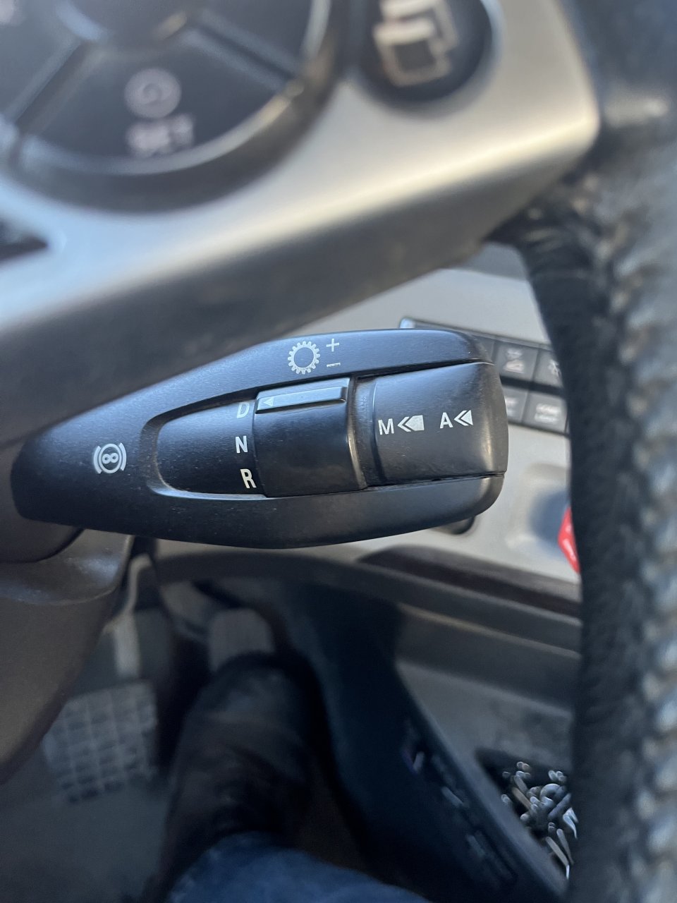

    IMG_1186.jpeg That’s my “gearshift.” Maybe I do have manual mode but idk how to do it.
    NightWind Thanks this.

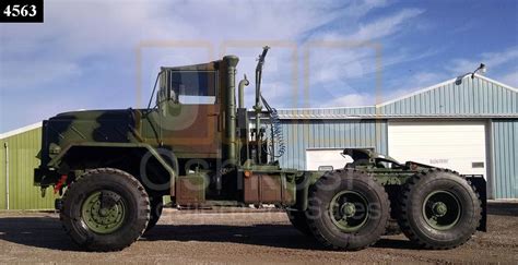

    And for the record they are AUTOSHIFTS not Automatics. There is not a torque converter in sight. I’ve only seen one true automatic and it was in this :
    Allison 5 speed automatic.
    And yes the autoshifts suck in slippery weather or on loose gravel or dirt, Volvo included. I drove a Volvo I shift for R&L for 18 months in a city operation and HATED it. The only thing worse was the transmission in the Paccar crap. It was neat how 1/2 the fleet froze up and wouldn’t go into gear and had to be drug to the shop to thaw out. Great times. Happened several days each year over the last 4 years I was there

    Push in on end of shifter (push towards steering column) to put in manual. Do same when ready to return to auto.
