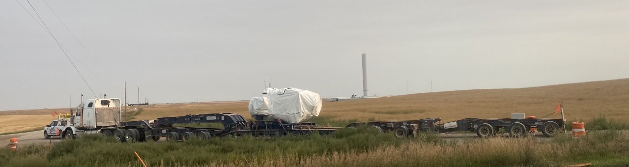

    220,000lbs 13 axle. Automated manual. Only had to tell it to start in first instead of third. Took a couple days to not reach for the shifter leaving a corner. Disliked that it would grab a gear going uphill and slow down, otherwise it was nice.
