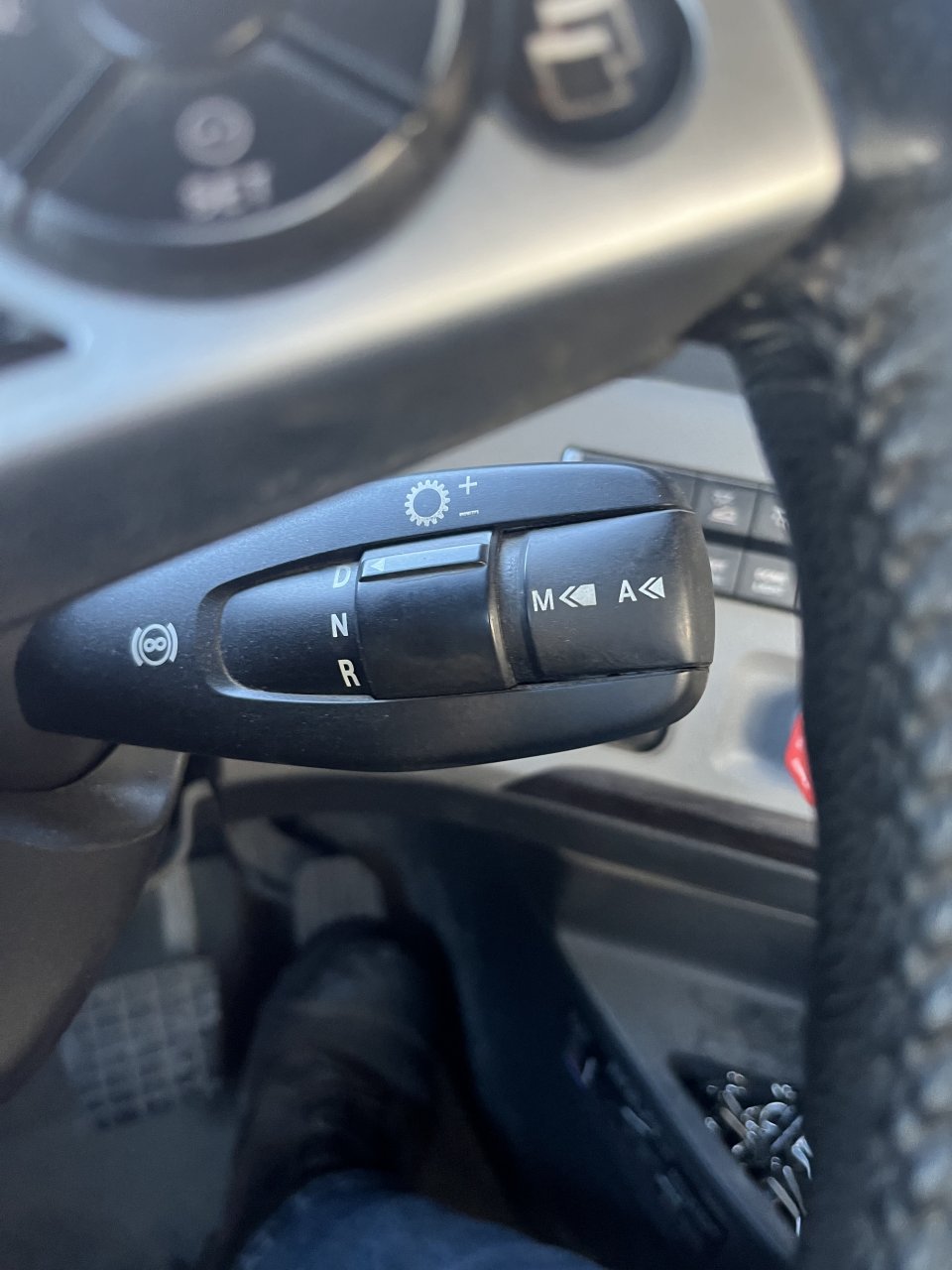

    Press and hold that button to get it into manual mode.
    OldeSkool Thanks this.
