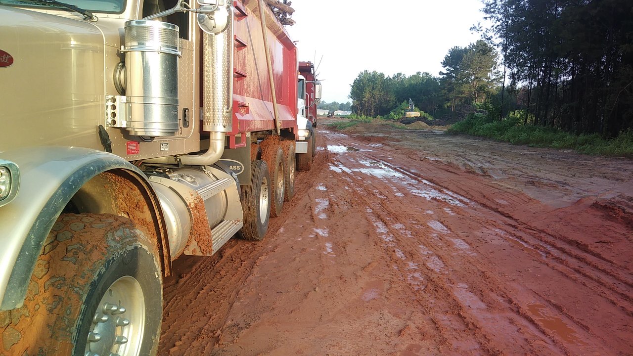

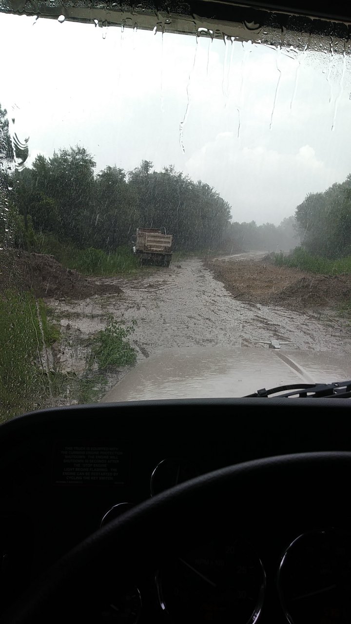

    0815180707.jpg 0814181549a.jpg Is it full lock diff or interlock diff or do you have both options? Do you have ATC? Can you turn the ATC off? Not sure make model you have. I currently have a PB 367 485 p/10s Eaton ultrashift. Very tempermental off road, too much computer control. Also exp. with earlier model Mack autos and manuals. I would stick with interlocked first then use full lock if needed or full if that's all u have. Turn off ATC if equipped or if u can. This will keep power from decreasing to a hub in a slip situation...which we all know happens in mud. Its all about momentum. When I haul in mud I'm well over 80k. Never used chains or seen em. Only on steel mill yard loaders. And of course for recovery, a basic item.
    magoo68 and x1Heavy Thank this.
