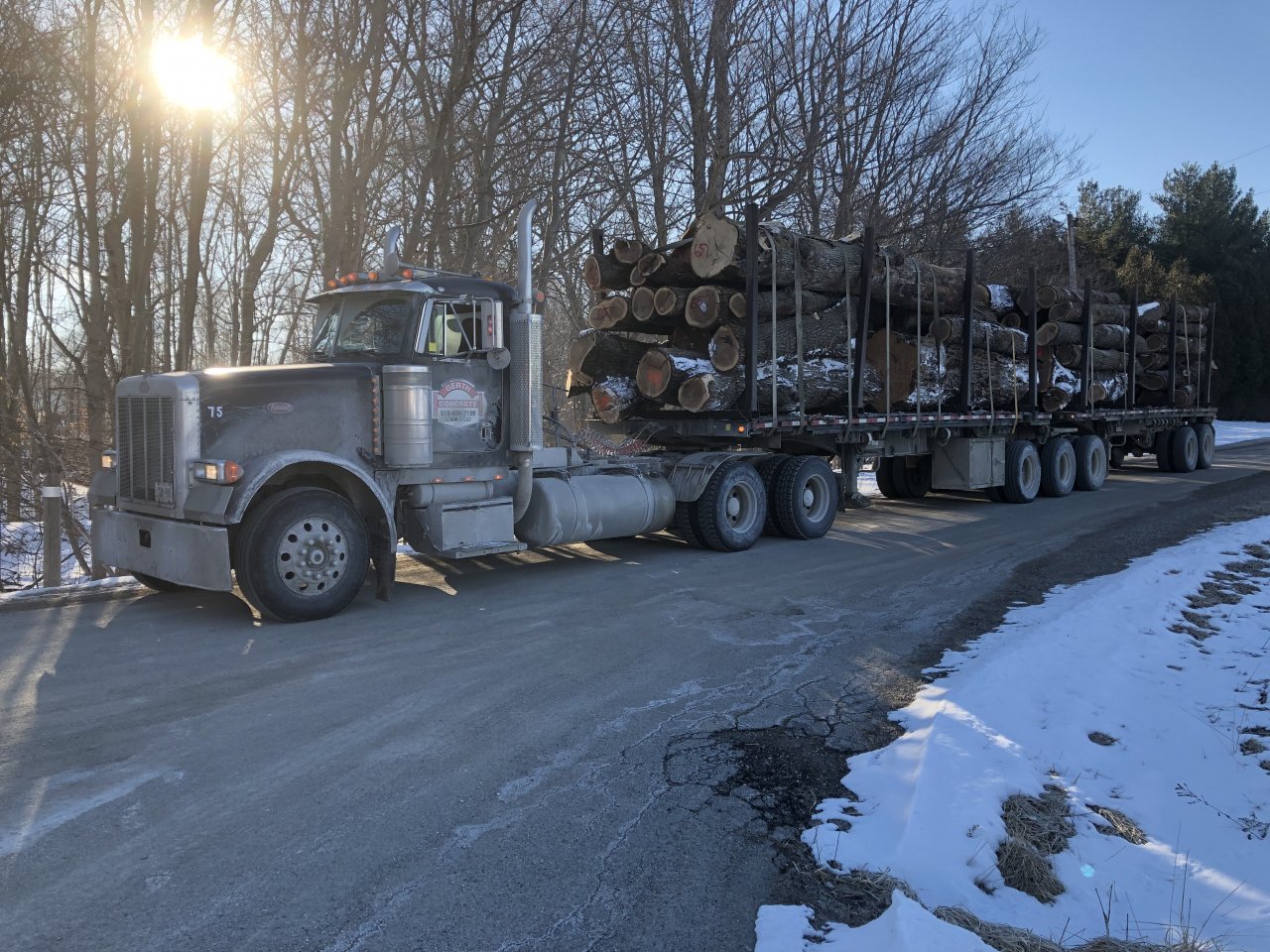

    Here is the 1992 Pete with 3406B cat.
    825EAE78-D74C-4B3A-AA70-72C3F86454BB.jpeg B20459AC-B54F-4588-BAB6-055D34BA8A36.jpeg

  7. Good bloom
    Good bloom Light Load Member
    75
    64
    Aug 13, 2017
    Chesterfield, MO
    rebuilding engine without licence how impressive.
  8. Shawn2130
    Shawn2130 Heavy Load Member
    896
    1,896
    Sep 20, 2015
    Southern Ontario
    Good Bloom; my boss is a licensed mechanic and he knows that I have rebuilt engines on farm tractors.
    That 3406b cat engine was a good learning experience.
