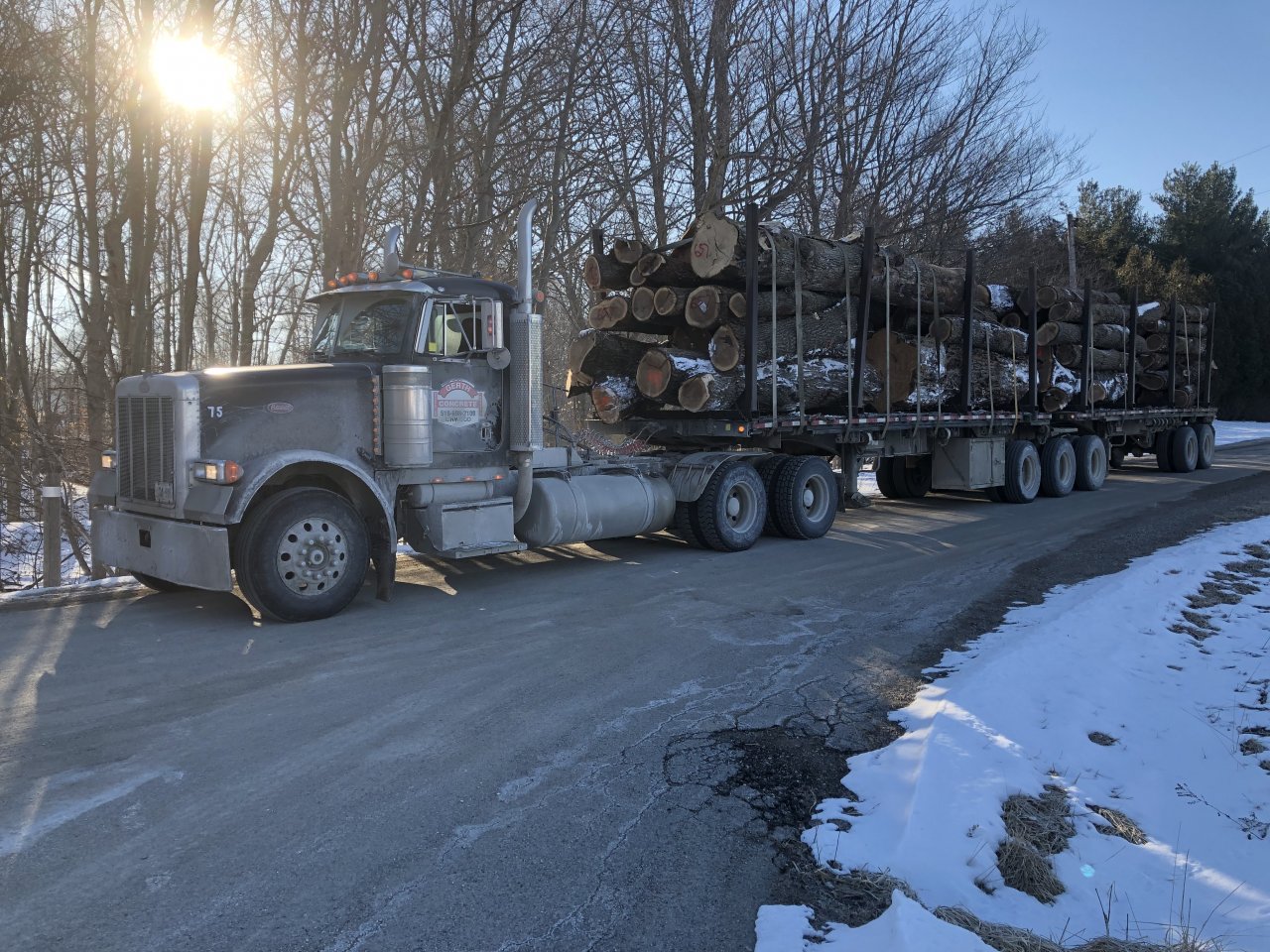

    Would be nice to massage some extra hp out of the 3406b, but it’s already using a lot of fuel.
    It’s averaging 3.6 Canadian mpg with the b-train.
    A 2001 Kenworth with a Cat picking up logs from the same site after me, caught up and blew past me with the Pete.
    If I had my freightliner, I’d be on his ##* or since I was loaded first, he would have no chance of catching up. ;)

    3.5-4 mpg is good economy for B-trains. That 4.11 setup is going to suck back the fuel on flat ground if you want to go any faster than 55 mph. But it will rock the hills like a boss.

    While 3.5-4 mpg is good, the freightliner managed 4.5-5.5 with the 4:11 gears which I’m very happy with. That also means a very happy boss.
    I am not sure what the Pete has for gearing.
    Will have to measure sometime.
