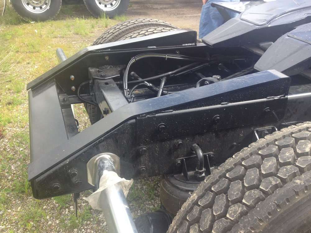

    Your truck is built wrong.

    Ya I could fab up some run ramps but in already so #### heavy I hate to add 200 lbs. Maybe I'll make some bolt on ones that I can slap on just for the 6 weeks a year I do ups.

    Carry 6 small blocks of 2x4's with you. Drop your air, place 3 blocks of wood stacked up, on each frame rail, so it just about touches the nose plate of the trailer. Then inflate your airbags. Your landing gear will now be 2-3 inches off the ground and easily cranked down.
    Dump air so you can retrieve your blocks, back 3/4 of the way under and bring air back up.
    30 seconds and no sore shoulders or busted crank handle pins.
    Note : put blocks of wood in a plastic bag as they will be greasy!

    Yes, it's fairly common. Mostly in heavy haulers work, but can be useful in a lot of situations.

    Ya I've thought of that. And I always say im gonna cut some 2x4s and put them in the head ache rack next year, but I never remember to until im 250 miles from home trying to get under a trailer that's dropped to low.
