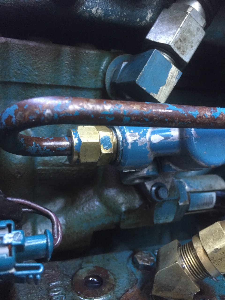

  11. B77
    B77 Light Load Member
    189
    89
    Dec 16, 2010
    What’s is the name of see picture Where the lift pump and ipr valve mount on 949FB628-6FF5-4576-8B61-54A309C5FBC4.jpeg
