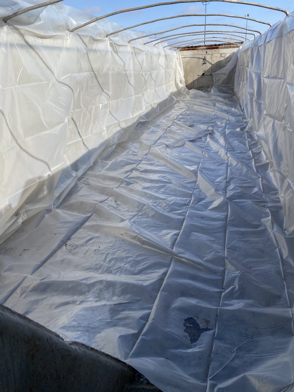

    There’s a number of things you can do with varying degrees of efficiency, and a lot of them take a little fine tuning to get the mix ratios right and to collaborate with the product being hauled. Without knowing how much contamination you’re worried about I’ll list a few of my faves and you can maybe pick what suits the load best, or if none of em work at least we tried. For diesel, I have a weed sprayer I fill up and coat the walls and the bed. I’ve also threw the nozzle up thru the front door (if your trailer is so equipped) at the truck stop and pumped in about 3-5 gallons. RV antifreeze works great and the magic to that is it’s actually “consumable”. I’ve used straight RV antifreeze and I’ve filled my sprayer up about 3/4 with it, a little bit of water and Dawn dish soap. The water helps the soap cling to the walls. I’ve also used corn oil for feed that I was afraid might stick. For your aggregates like clay, red shale, mill scale and things like that if you get 2 bundles of straw, bust em open and spread them on the floor of your trailer, load your product on top of it, it’ll come out like poop thru a goose. Used motor oil works well and as mentioned, diesel is king but that’s with hardy loads that don’t matter if they get gunky. I’ve also used big sheets of plastic. Spread it out on the floor, bring the sides up along the walls and push your bows thru the plastic into the bow pocket to hold it. The weight of the product moving will slide it all out plastic and all. These few tricks have worked for me in the past, lime can be a terd even when it’s not this cold out. Hope these suggestions help. Best of luck.

    I didn’t explain the plastic sheeting very well. Here’s a picture of what the end game should look like
