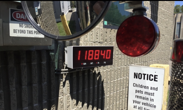

  11. abyliks
    abyliks Road Train Member
    3,925
    9,199
    May 2, 2010
    ludlow MA
