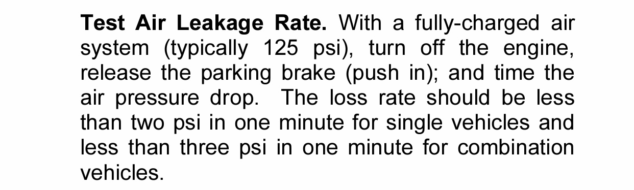

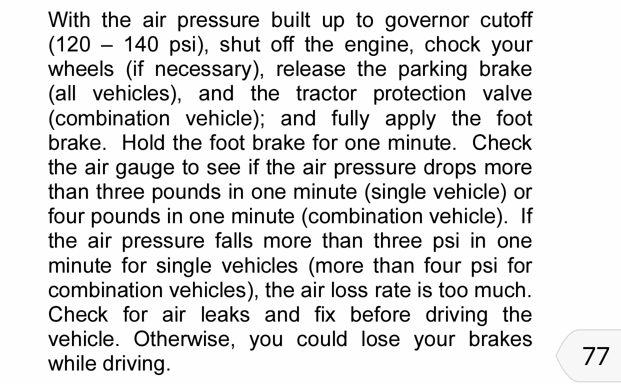

  11. PE_T
    PE_T Road Train Member
    I’m not understanding. I meant to say if DOT performs an air leak rate test on the truck, it will likely not pass. Here are two air leak tests found in the TX CDL manual. I must admit they have never performed these tests on me, but I have never had a level 1 inspection.
