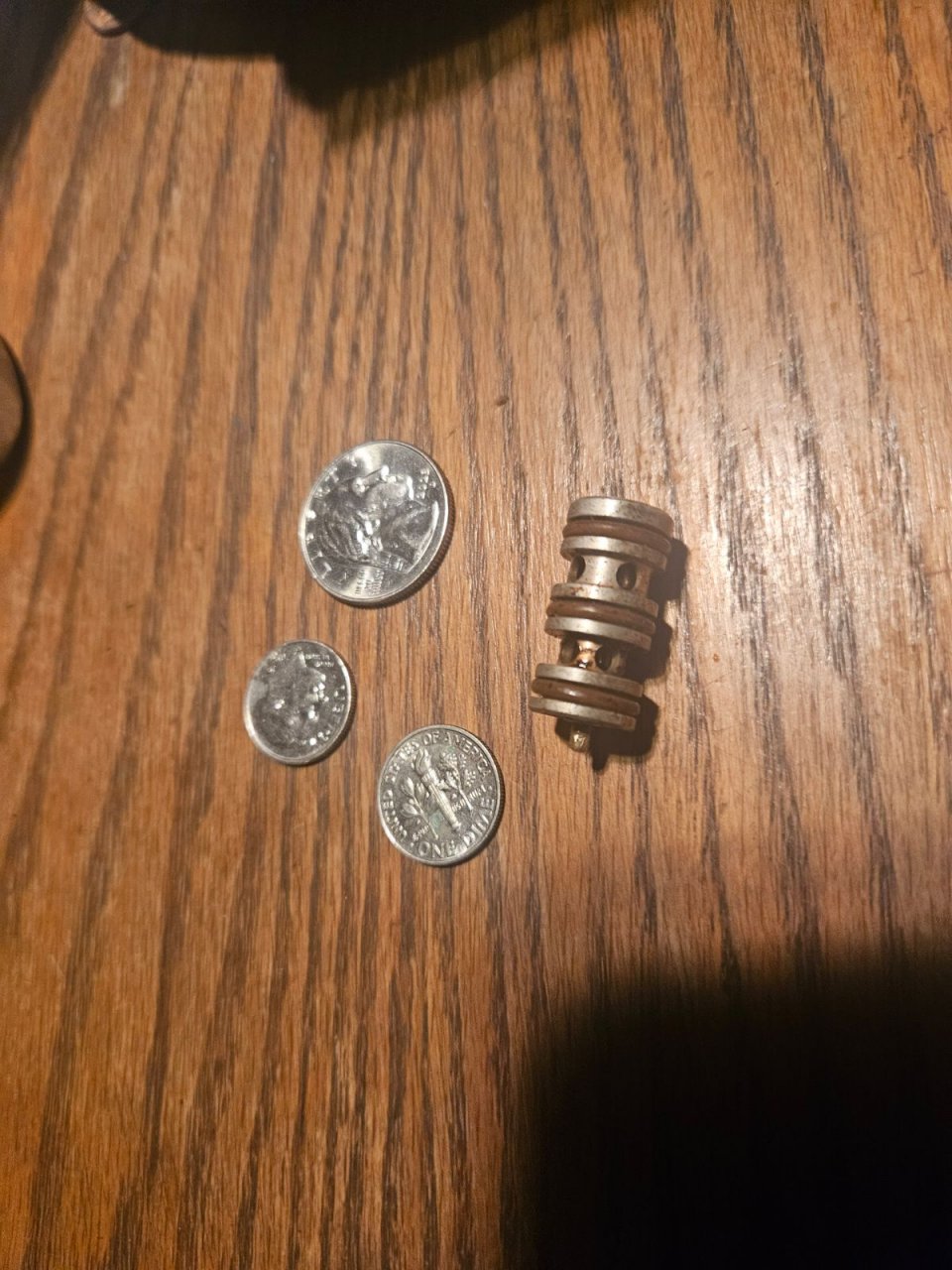

    Had a truck that wouldn’t split the high side, which made it a 9 speed, for the remainder of the day. Transmission is a RTO12513. Disassembled the splitter on back of transmission and found the little valve to be sticking. Anyone know a replacement part number for this little valve? image000000.jpeg image000000.jpeg

    I don't know the #. I called it a shuttle valve. Comes in a kit IIRC. New splitter piston O Ring, gaskets, and the shuttle valve.
    Eaton has a great online parts manual for getting #'s.
    If you can find it in a diagram, the first # listed should be the individual part #. There will be a second set of #'s that show all the kit #'s it comes in, usually starting with a K- and 4#'s.
    I would pull the piston and replace that o ring too, and be sure to lube those o rings

    Looks like K-3331 for the kit. Scratch that. That's the kit with cover.
