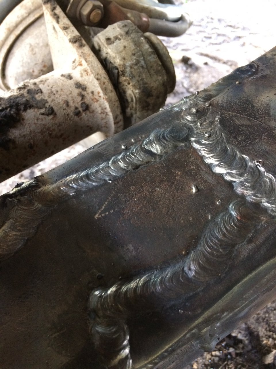

    Housings can be rewelded. Tens of thousands of Eatons have been fixed like that for going on 25 years. They all crack at welds on the spring perches.
    If you have Eatons and always have moisture in the oil. There is a crack somewhere you haven’t been able to see yet around those perches.

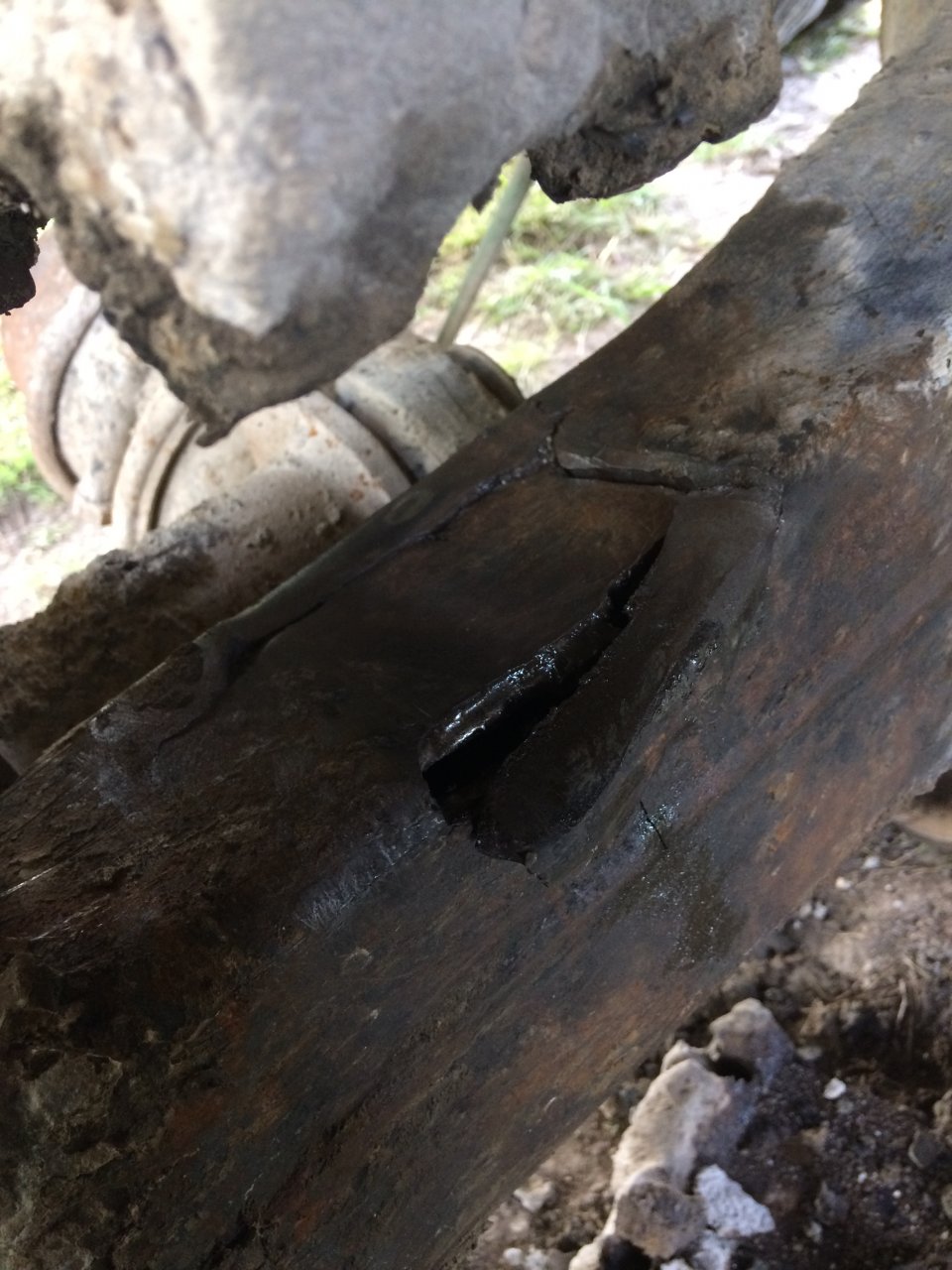

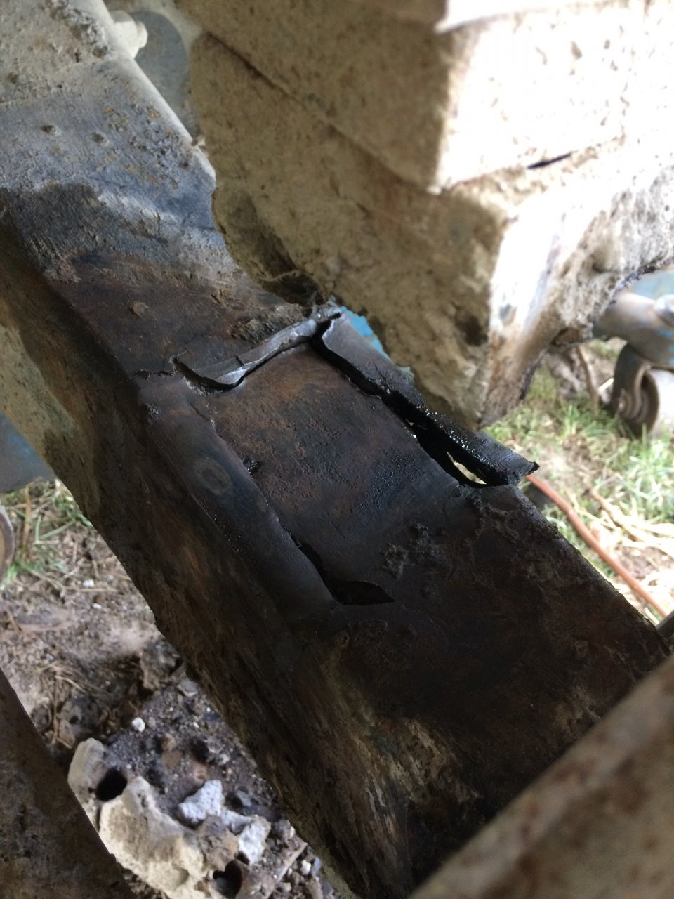

    Yes, I have done quite a few and Rockwells to BE288917-5014-4803-B42A-B5BBA81C0B85.jpeg 5967B78A-EC2E-4AA8-9EA8-198454B91858.jpeg A5D4C0B5-6E56-4879-B1A7-B515BC111CB8.jpeg the worst one I have ever seen was this Rockwell sqhd

    They’d been known get nasty like that under the old Freightliner spring setup. Because of the rotating action of the center spring mount under the fifth wheel weight they would just rub till there was nothing left on top of the tube.
    That being said. That is worst i’ve seen too. Looks like it was torn off.

    The pictures hardly do it justice
    That tube was really only connected across the bottom and about 1/2 way up the front. That was on a reyco 4 spring and really hadn’t wore down that bad just cracked all to pieces. We did replace that housing after asphalt season ended mostly due to concerns with miss alignment of the axle shaft and wearing the inside tire. All of the welding was still looking good.
