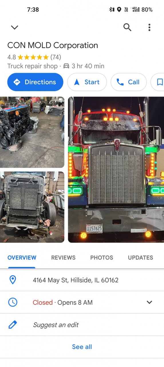

    I have an old Volvo truck and got air assisted clutch cylinder installed at this shop. They had to drill the frame and install brackets from a Freightliner, but everything works great and the clutch pedal is so light now, a child can press it with a hand.
