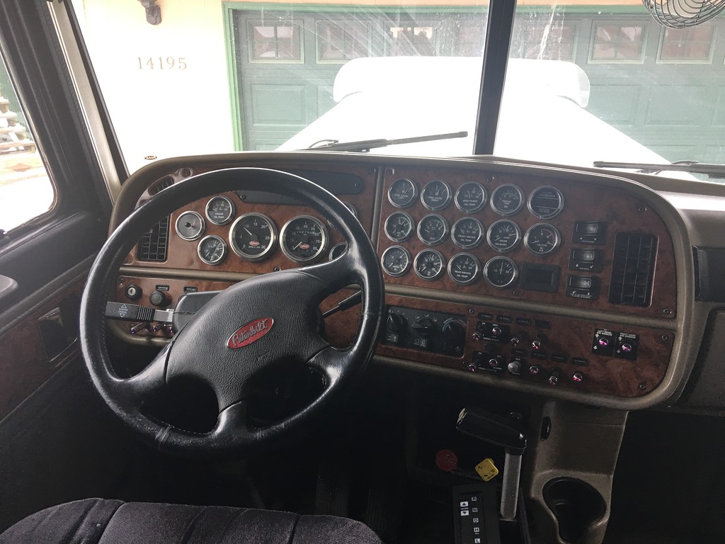

    To the best of my knowledge, my trany is a first gen
    "Auto-Shift" I still have a clutch pedal that has to be used before going into gear, moving from a dead stop, coming to a dead stop and to put the trans back into neutral. Here's a photo of my shifter, there are up shift and down shift buttons on the left hand side of the shifter T-handle.
    Thanks for your reply and suggestion.
    Dave
    brsims Thanks this.
  11. brsims
    brsims Road Train Member
    5,296
    6,522
    Aug 8, 2009
    Meadville, PA
    Yep, yours is the older first gen model. Sorry, I have no knowledge of the diagnosis on those. Mine is second or third gen, no clutch pedal and better programming in the ECM.
    Mr. Cob Thanks this.
