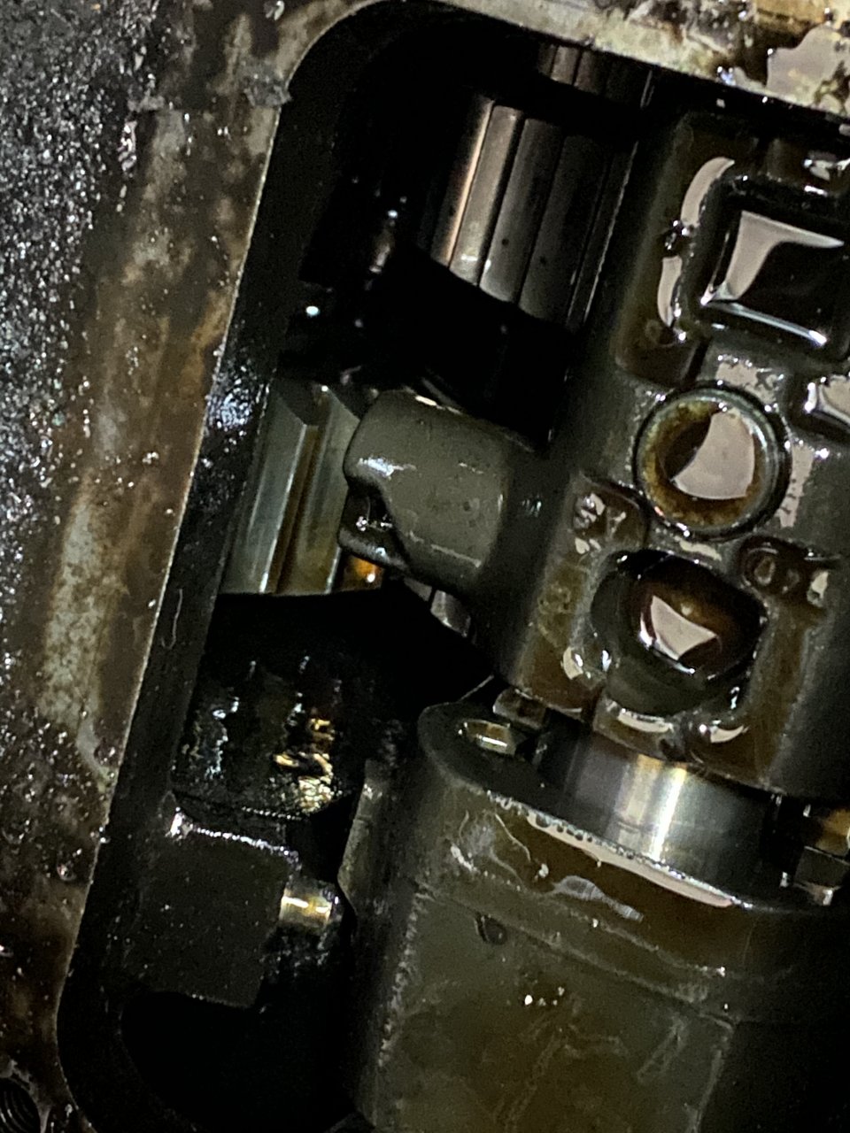

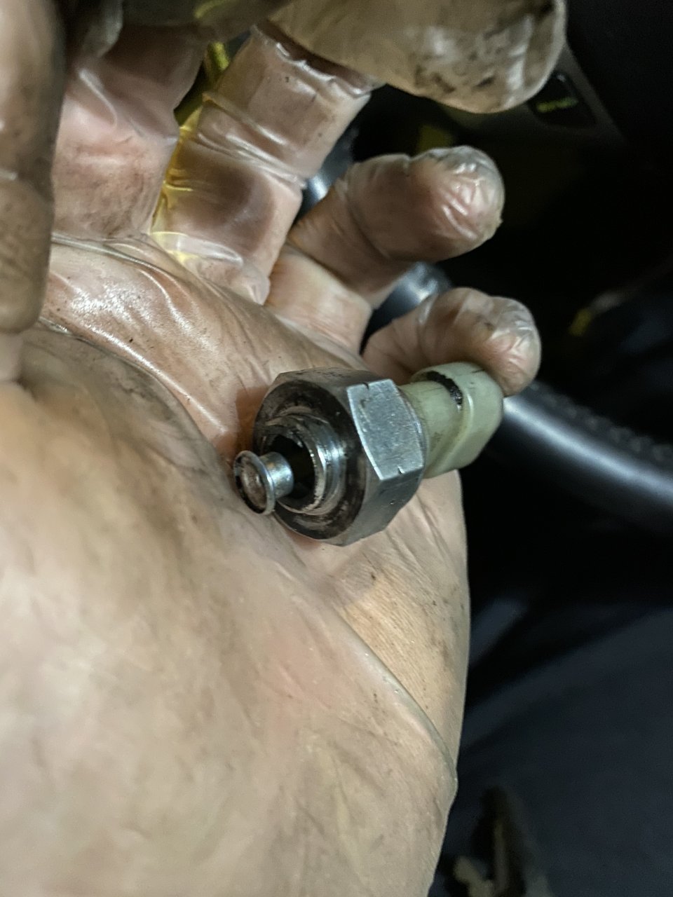

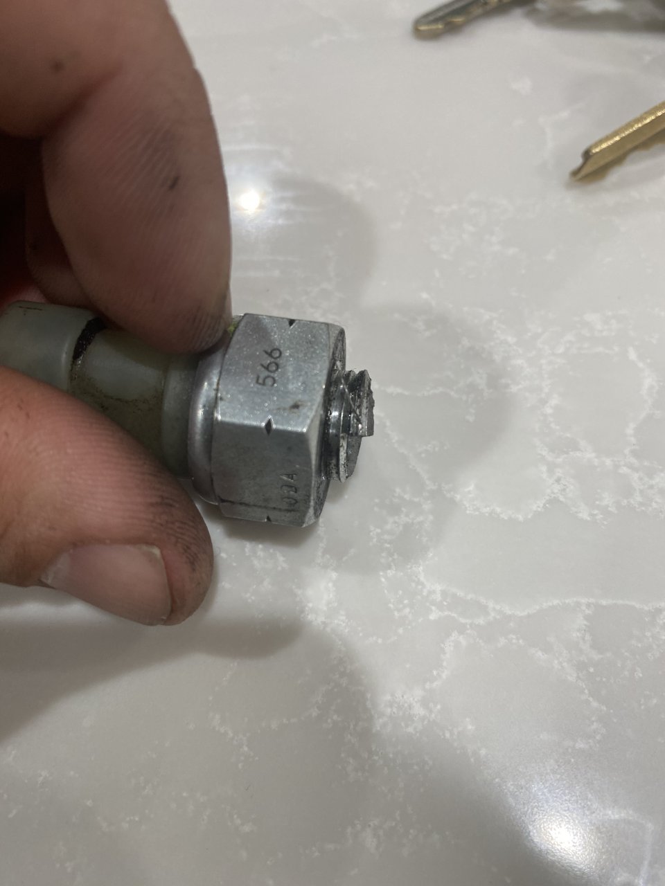

    FAF85787-6F9B-499E-AC56-D0D40C8C5A93.jpeg 97AF7C57-394B-44E1-A31B-8BDAFAD86BA2.jpeg 42DD858D-1C7F-43CA-B9BE-3E8C4862C318.jpeg
    Long story short - reverse light switch broke inside Eaton 10 speed , went the ez-out route . Now the shift won’t go into reverse gear . I had the easy out on a drill but was not able to remove rest of switch . But inside I think i jammed something . Any suggestions? Thanks In advance

    Have you got the new switch so you can cy how deep its safe to drill then buy a easy\/out then use a wrench on it to get a good bite with it and it should come out.

    That’s what I did but it made matters worse . Now I can’t get it into gear

    I would have to thank that if people were just driving the truck and not working it something internal would have to have happened in order to break the switch. Possibly the shift fork is bent. That could allow the shift fork shaft to travel further than it should. The reverse switch could cause it to bind because because it exceeds it travel limit in the detent shot.
    Use a bar to shift it with the tower off and the switch out. Does the work?

    Did you get the ball out of the old switch out of the hole the backup light threads into?

    If your talking about the ball at the end of the the switch. No I haven’t . I don’t know if that’s what’s sticking out or it’s still in there

    I suspect that is your issue. Take the new switch out and see if it will come out with a magnet.
