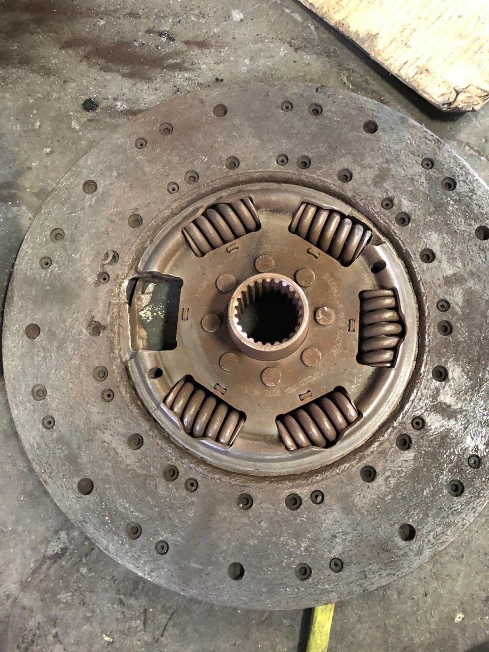

    I had to "pull start" one of the company's Volvo with IShift from MO to WA once (both full load) with the issue like that with a chain from trailer, won't start moving. Once it starts moving, it goes. After pulling transmission off there was one of the springs on the disk broken and stuck.

    Probably new clutch time, but needs troubleshot.
    Clutch failed to release
