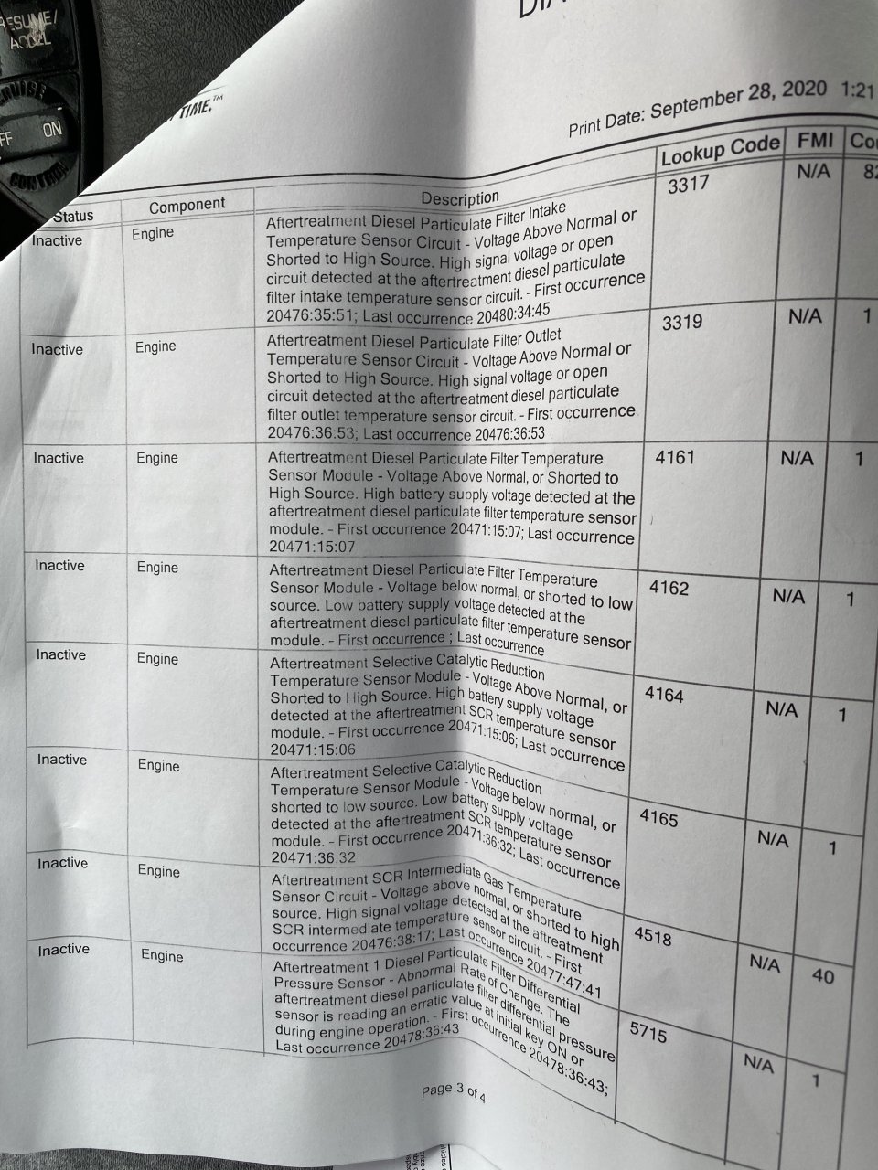

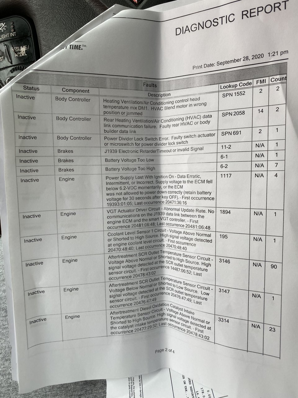

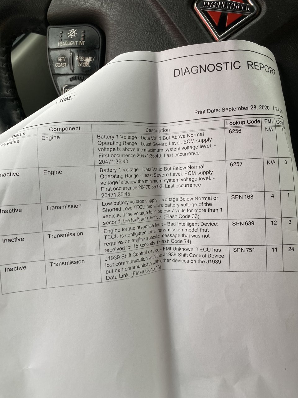

  7. Kbhairo
    Kbhairo Bobtail Member
    29
    7
    Oct 3, 2020
    Someone please help me international prostar 2016 with Cummins
