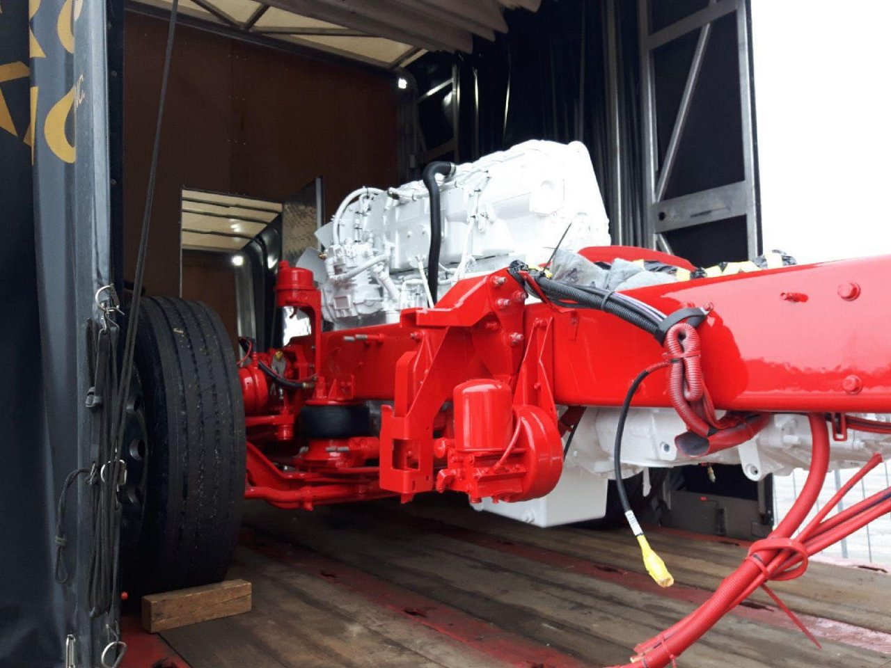

    I’m not sure who make them. But, this Rollin’ Transport truck, called “Benchmark”, has one. The front accessory drive area of the engine is so clean on this thing. Unfortunately, trying to find the IG pic is impossible.
    C60A09C2-C9B9-4A49-B9BA-B5DF026EE8F0.jpeg 0921C83A-1589-4992-B488-C006AC809453.jpeg
    Rideandrepair Thanks this.
