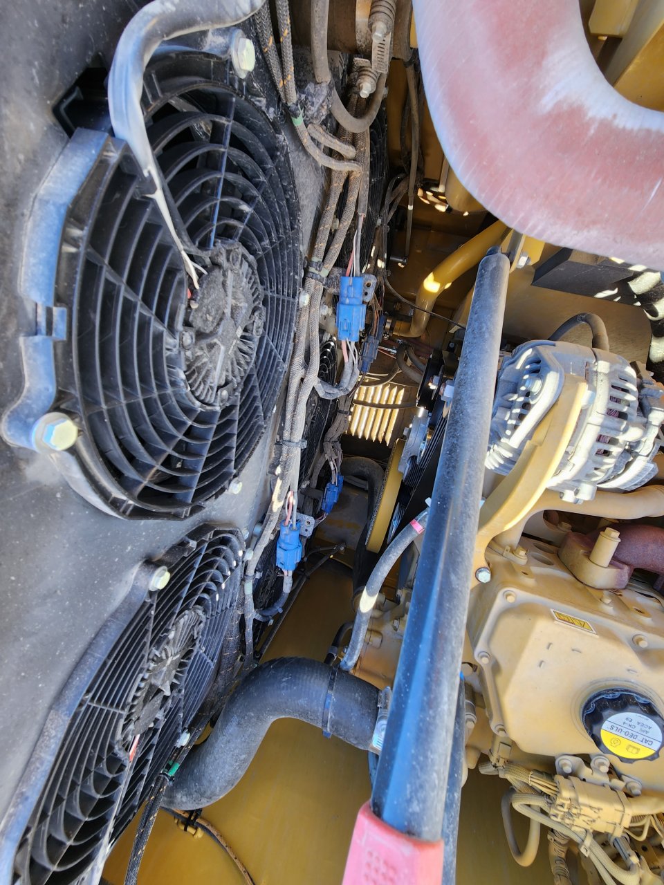

    Here is what is on our new excavator. Eight fans in all.

    dang 8 fans! looks great!!! did you have to upgrade the alternator? if so how many amps? i want to upgrade to a 200amp delco remy seen them for almost 400$
