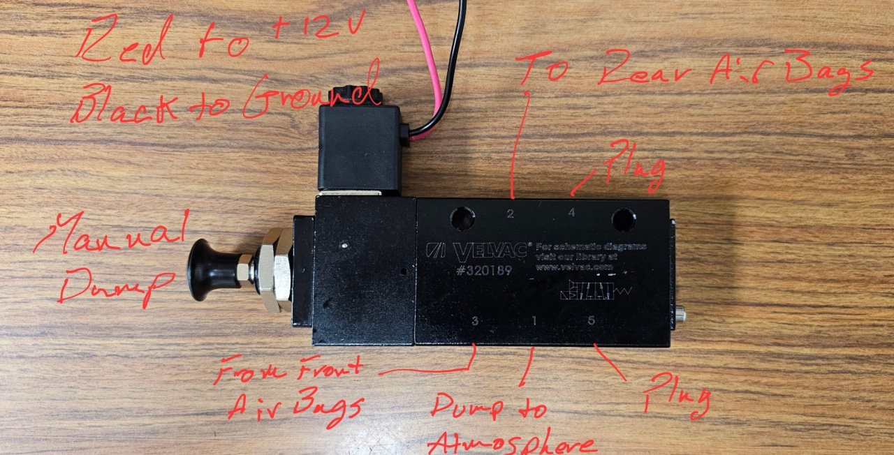

    This is the Valve I use for dump axles. It is VELVAC Part # 320189. It isn't going to dump super fast but if you know you are coming up on a tight turn or just maneuvering on a jobsite you can hit it ahead of time.
    On my truck I have an auxiliary 7Way plug which uses a reversed ground pin so you can't mix the plugs up. Mine is factory wired to a switch on the dash to feed +12V to the center pin.

    I appreciate all the info. I found a Reitnouer with a lift axle already there so I'll just want to put on the solenoid for in-cab operation. I don't see a dump on the rears but maybe I'll do that later. Thanks again to all. even those who only made me chuckle.

    Get yourself a engine fan electric over air solenoid/switch, i use the Horton one. Mount that near what you want to control, plumb air for controls, run wiring to what style plug you want. Then wire switch in cab and run wiring to plug.
