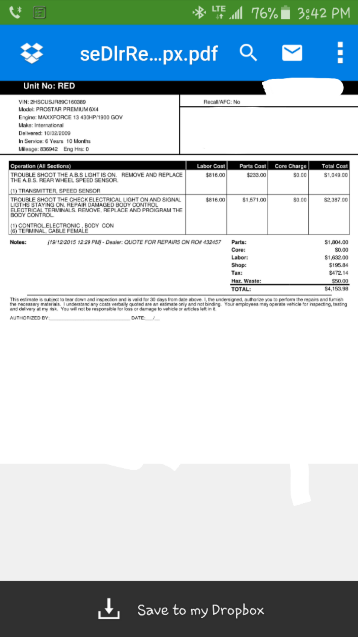

    Hello Guys. I just bought 2009 International pro star premium eagle . After getting 10 new tire . I got loud beeping sound, traction sign , Abs light, Electrical fault sign and All gages went down. But truck was still running and also it was OK with idling. I took it to International dealership. After looking at estimate I don't know what to do . Any advise? 2015-12-22 21.17.37.png I am also going upload estimate with problems. Thanks

    This is why repair shops get a bad reputation. An ABS sensor cost me 60-$90. If I charged 3 hours labor to replace it, I would be ripping you off. I am pissed and embarrassed and it is not even my shop or truck! I am too pissed to even rant...........

    Is there anything else you like to add on regarding the issue? Forget the price and labour .

    So did you have anything fixed yet? I do not believe changing tires will cause any of that. If you just bought this unit I think you should talk to whoever sold it to you and see if they will do anything about it. Body controllers rarely go bad by themselves. Low voltage cranking and boosting is what usually hurts them. Also the wiring is tied too tightly which pulls and stresses the connectors and therefore can break the soldering on the motherboard inside. The body controller is located to the left of the clutch pedal, near the floor, behind the small kick panel bolted to the inside of cab. The kick panel also puts pressure on the wiring and connectors. I would remove this panel and wiggle the wiring to see if the problems change or go away. That little panel, I never reinstall that long skinny bolt that screws into the firewall that takes a 10mm socket. I find it squeezes the wiring too much which can lead to problems. Leaving that bolt out will not hurt anything and allows more room for the wiring behind it.

    Thanks Heavyd. I really appreciate your help. I haven't get it fixed yet. And I bought this truk as is . So can't really ask them anything. But I will definitely try the steps before paying someone big chunk.
