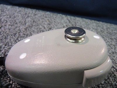

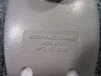

  11. rabbiporkchop
    9,681
    6,537
    Feb 9, 2012
    Wapwallopen, Pa
    I just discovered one that I've never seen before on eBay and it looks just like the 602 but I can't find specifications on it.
    I'd be willing to bet that it would work just as well as the 602 series.
