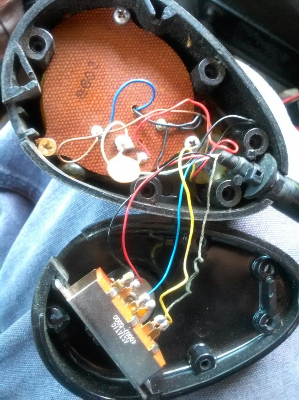

    I opened up my oldest Telex RK56 from my collection and this is what I found inside. I had the switch replaced about 8 yrs or so ago cause the spring had broke. Telex RK56.jpeg

    Inside look of my SRA 198[​IMG]

    If you gently lift the cable strain relief from the case the Transformer is held in place with hot glue underneath.
    It has 4 wires yellow and red
    black and brown
