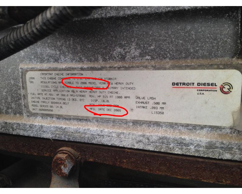

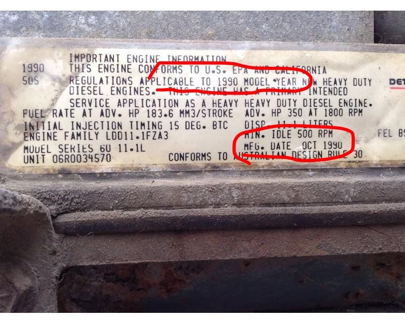

    In most cases model year and built year are the same.

    Not to further confuse this. To clarify, it will go off the stickers? Not the last 6 digit numbers on the block? I have not found the numbers on the block but freightliner assures me they are there. If so i see those stickers becomming valuable.

    It is common for the engine build date to be the year previous to the truck build date.

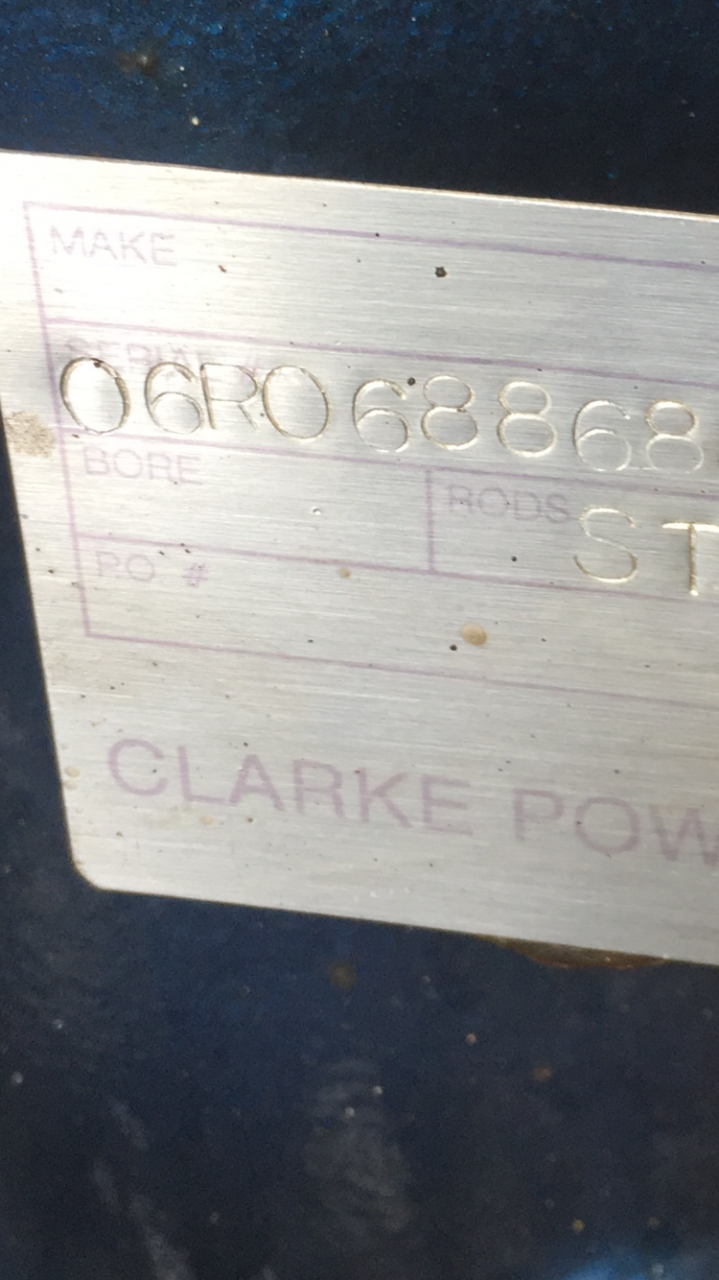

    I was referred to Clarke Power here local as they service the Detroit engines. Our local Freightliner could not give me information off engine serial. They referred me over.
