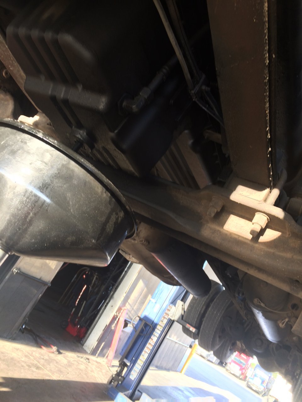

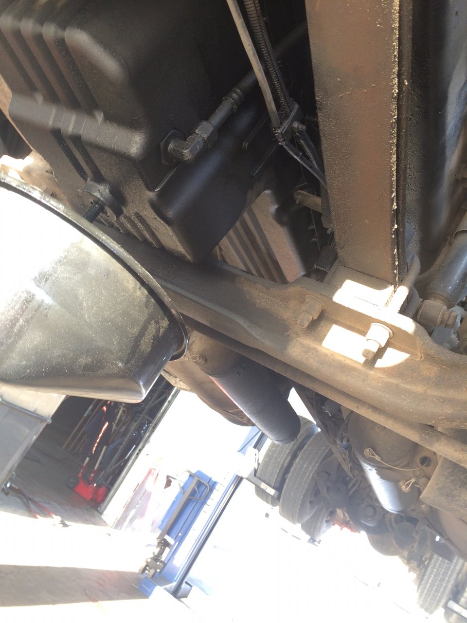

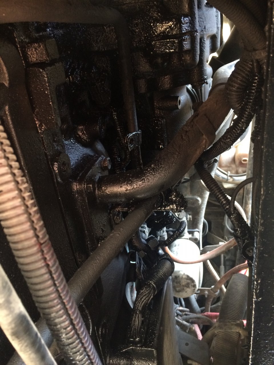

    Hi,
    Where do you think the oil leak is coming. Cam seals?? Pictures attached
