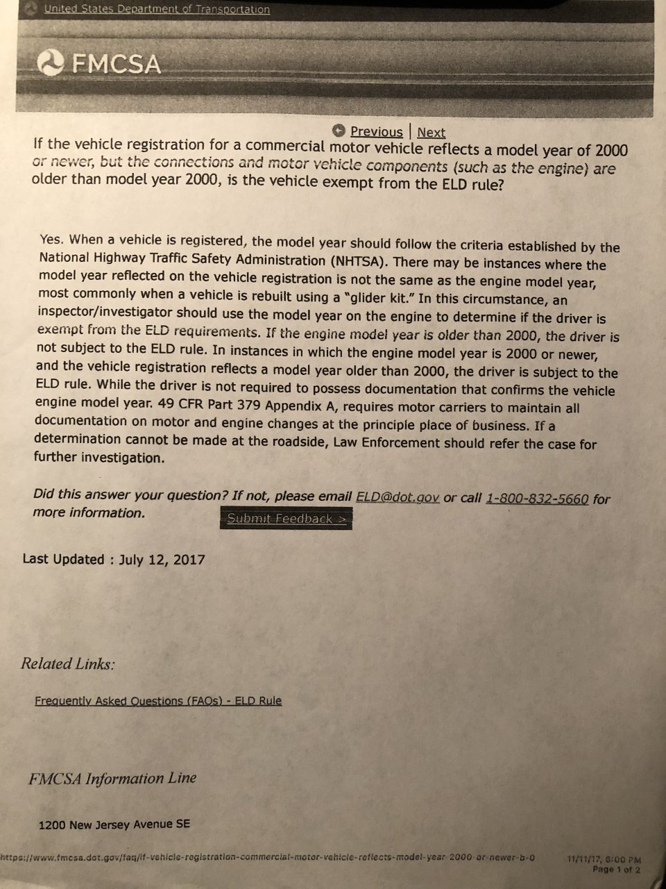

    2416B56B-3540-44A1-B3B6-FCE59E2A898D.jpeg Mine is Titled 2001 Build date early 2000. Engine has a build date of Nov. 1999. Looks like the Truck was originally destined to be 2000, My guess is due to all the Repos at the time,new sales were slow. I’ve Been inspected twice, explaining 99 original to Truck. No problems (yet ). I keep a copy of this with my Log book.Says it all

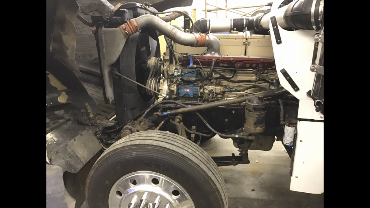

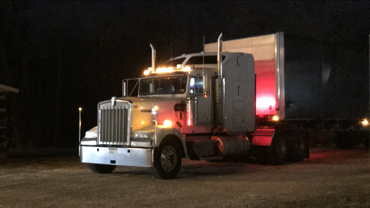

    7EB656E9-A19B-4E64-8345-E488A80C28B5.png 2CDAD513-1A7B-41CA-A28C-2F81A97D9792.png
    My truck is a factory glider ordered new in 1994 by Sheppard in Pennsylvania. Titled as a 1995 model. Sheppard, Ross, & TRW build steering gears..... guess which one is on this truck ;).

    It looks naked without the after cooler.

    It reminds me of a Minneapolis Moline or Case 1030 6 cylinder engine lol, 3 sets of heads and all.

    So the consensus seems to be that if you repower with an older engine, it is legal and ELD is not required.
    That makes sense but there must be a certain year truck that emission regulations came in that you can't just change the engine. Can you?
    Are there regulations on emission control trucks that you can't just change the engine and do the same thing? Those trucks are from what year 2010 and up? Or can you repower them also?

    The consensus may be that, but the EPA and most states will hold you to the idea that you bought a truck with an newer engine in it, it has to be replaced with tha same type of engine with the same year or newer emission controls.
