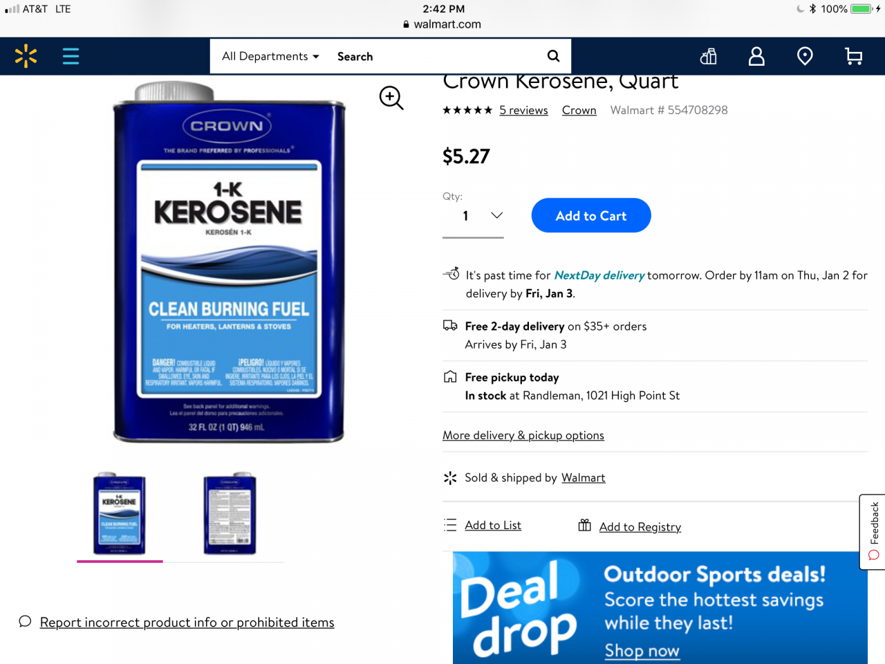

    C19BA180-0F7E-4C25-B7CC-99B40976F89A.png Local to me Walmart stocks it. Lowe’s and Home Depot probably have it.
    PermanentTourist Thanks this.
  11. PermanentTourist
    PermanentTourist Heavy Load Member
    749
    881
    Nov 9, 2016
    48 states + Canada
    Nice. That's super cheap too. I'm sure a quart will be enough to run the that efficient little heater for half an hour. While I stand by with my fire extinguisher just in case, lol.
    Also, I didn't even know they still made kerosene. I was imagining like Little House on the Prairie pioneer times when I hear about it. Today I learned.
