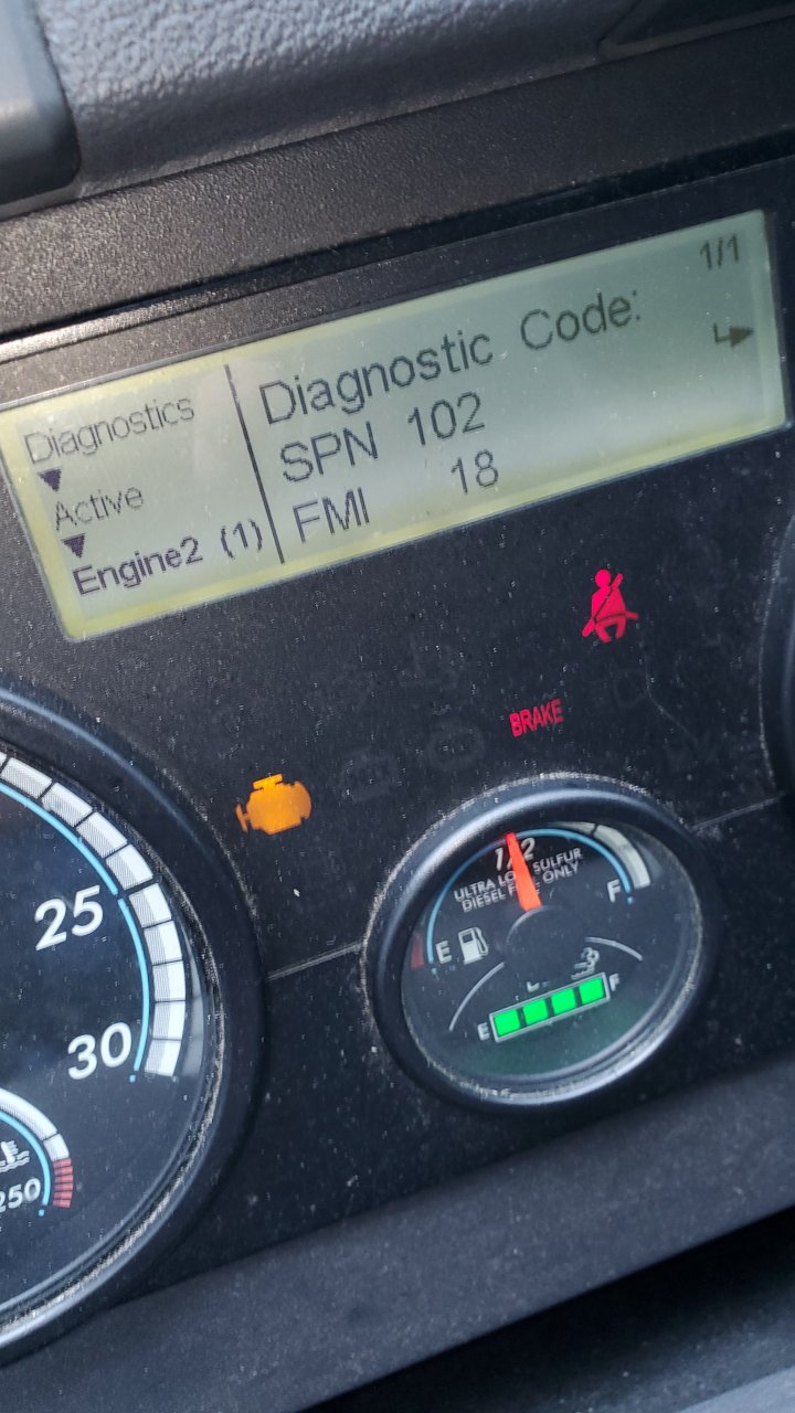

Hi
"Air intake system problem detected 25% Derated"
SPN 102
FMI 18
This is the only code 4 dealer shops and 3 local shops couldn't solve the problem
We changed all sensors in that matter and code all houses and pipes.
If anyone can help so solve the issue or have the same experience please let me know
Thank you

SPN 102/FMI 18
Description This Fault Code Sets When the Intake Manifold Pressure is Lower Than Expected While The Engine is Under a Load.
