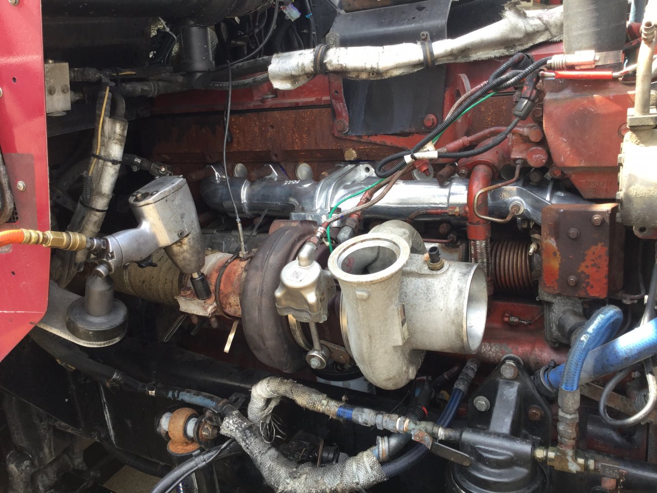

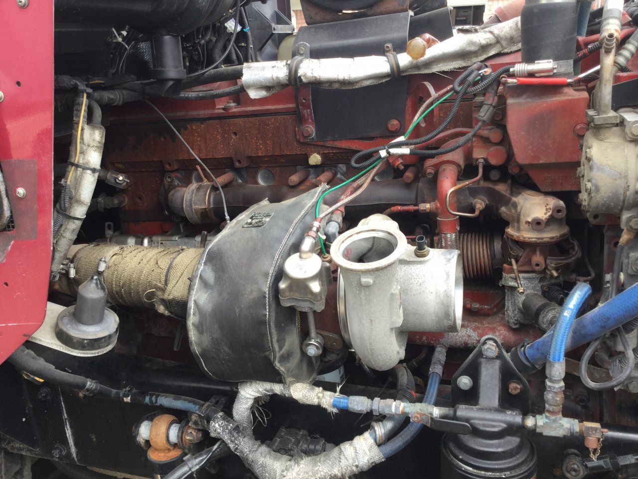

    We put a ceramic coated bully dog, which I believe is made by full tilt, on an ISX 870 a few months ago, EGTs are down 100-150 degrees, seems to be helping on fuel mileage too. We ordered it off Jeg’s, it showed up two days later.
    Original mainfold
    Bully Dog Cermanic Coated

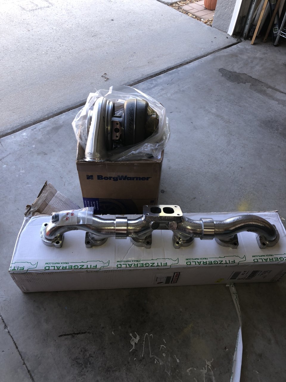

    Just ordered the Full Tilt yesterday. If you need the low mount, Fitzgerald’s has the best price. It should be here tomorrow, and my BW turbo came in today. I can’t wait.

    Oh nice I didn't realize they were the same lol. Pittsburgh power has been them for 1450, how much are they from Fitz?
    Edit: Looks like Firz only sells the center mount type. Mine is offset towards the front of the engine.

    It came in today. They only have the one model in stock.
