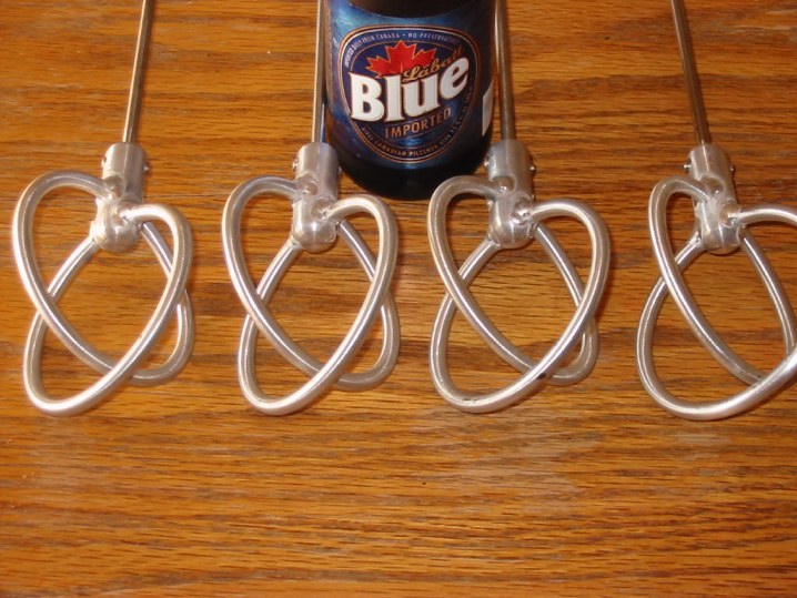

    Once you got your antennae configured the way you like it and the whip is at its maximum practical height here's another way to increase the efficiency of your antenna by reducing inductance of loading coil by shortening the coil and adding a capacitance hat once you get into the realm of tunable coils like the ones I make.
    http://www.smeter.net/antennas/short-top-hat-loaded.php
