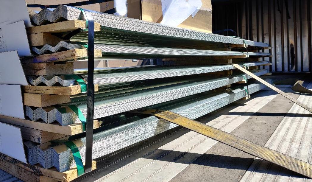

    So here's a photo of a unitized bundle. If the steel strapping is strong enough, can I just run fabric straps through the lower layers and then the top layers are also secure? Or regardless of steel banding strength, must fabric straps be placed over the top of the bundle anyway?
    Usually each individual skid is banded to both the skid below and above it (but not so in this example). This makes one large unitized bundle. These are LTL deliveries and by fabric strapping at the bottom, then only the steel strapping needs to be cut in order to remove the top skids at each delivery. Photo of securement straps on unitized bundle-cropped 2.jpg

    Why wouldn’t you want to add 3 straps across the top in addition?

    Strap over the top and be done with it

    Looking at that pic & what OP wants to try, I don't think that 3 wraps of banding comes anywhere close to meeting the .8g deceleration & .5g lateral requirements.
    You could just unwind your top straps at each stop & the forklift can pull layers out from under the straps. That would at least save you having to roll up & throw straps back over.
    That is unless the tin would tear up the straps.
    Another thing to think of is "How would I make DOT believe this?". You could get in some hot water for something perfectly legal just because it doesn't look right to an officer.

    I would put straps where the banding is, they will pull down on the dunnage and hold better.
    Get a rubber mud flat for protection, to make each stop easier cut your straps to length, no excess to secure and they’ll tighten quicker.
    If the pieces are over 10 ft long put a strap over the middle to keep dot happy.
    the way they are loaded in the picture I don’t think you can get a good enough pull on them to keep them from sliding on the aluminum deck. Friction mat would help.
