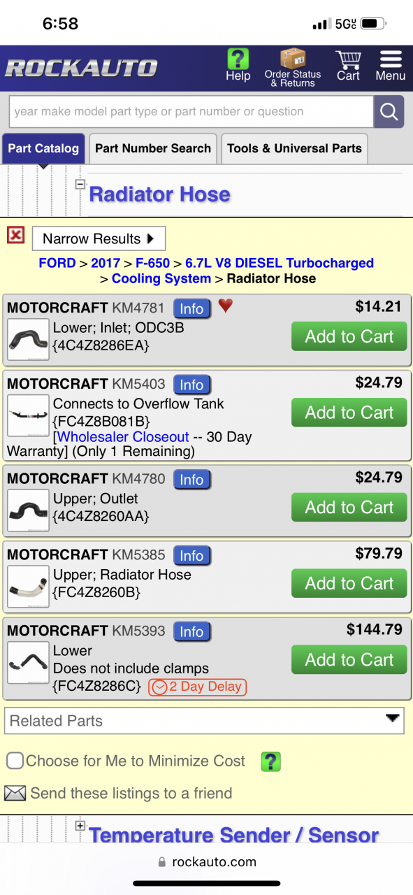

    Why cant I find a radiator hose for an F650? Reached out to ford and get no answer.

    What year/motor? Guessing it a preformed hose, not something you can just get off the shelf?

    2017 6.7 one of those goofy hoses with plastic ends.

    Motorcraft #?
    location?

    Hawaii. I ended up sectioning out the chaffed part and using a metal tube.

    it was the lower hose. odd part is that it looks like it had a factory splice in it. no matter now, or for now, i cheated it. dodono what im gonna do next time i need a hose like that. the ford parts site is a mess, and still no response from them.
