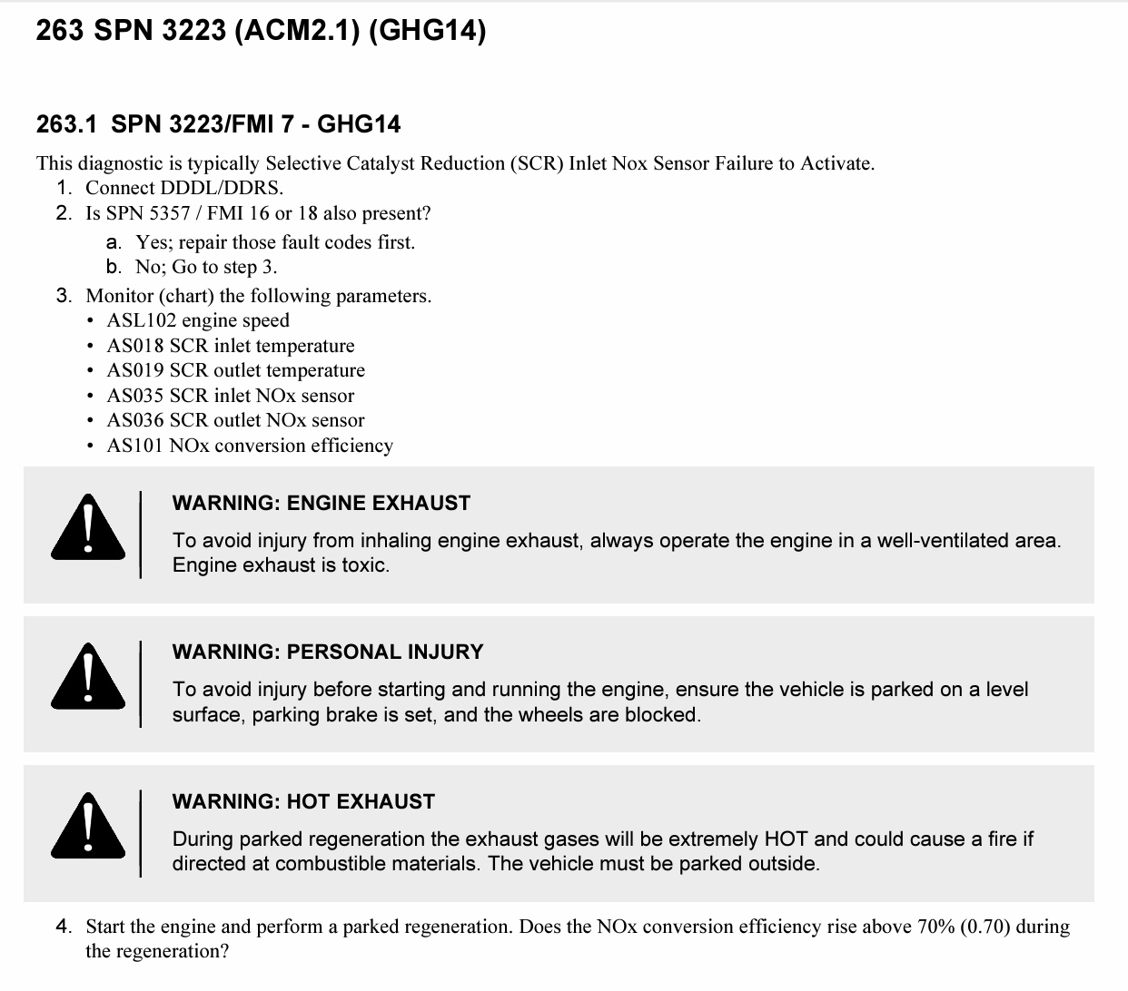

    I have a 17 Freightliner Cascadia and just got a fault code spn 3223 fmi 7. Does anyone know what this is?

    Raw Nox sensor

    Images below.

    Had to replace Inlet Nox sensor and then the outlet Nox sensor a week later
