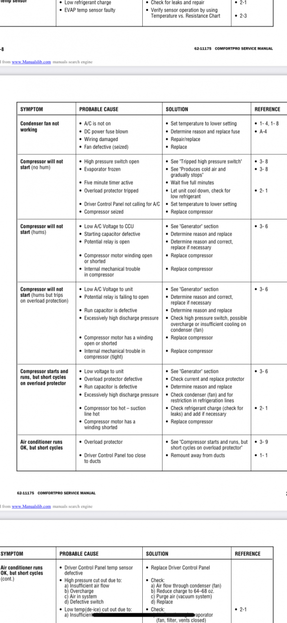

    Having an issue with my APU.
    The last few nights it will just turn off several times during the night. I wake up rather chilly and turn it back on and try to get back to sleep. Rinse/Repeat ... then closer to morning it stays on until I shut it off like normal. I’m well within the 10 hour timer that shuts itself down.

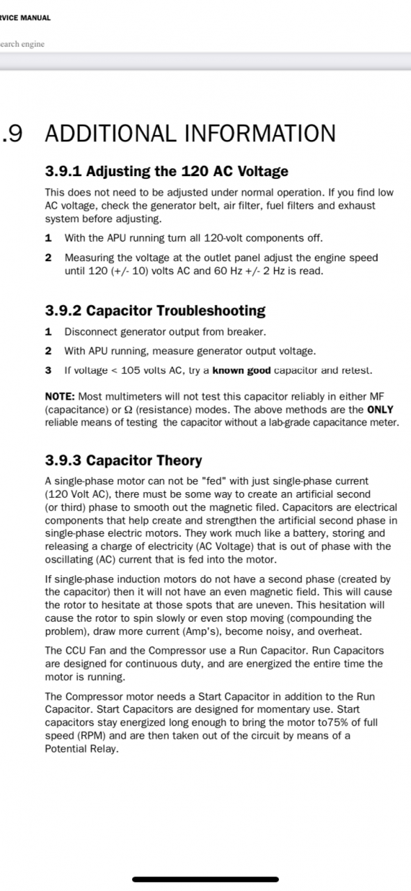

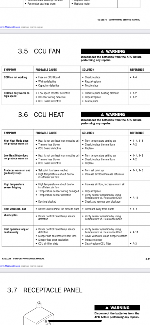

    I have same unit you company fellas have on star car. did it stop producing power and shut off as well or just heat.
    If no heat and no power there is a capacitor inside box under bunk that carrier will change. Notorious for going out.

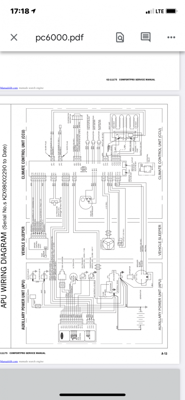

    If knew how how to upload the schematic I would.

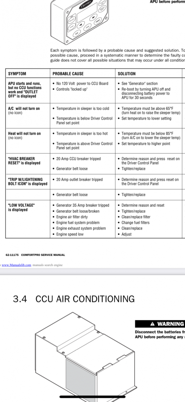

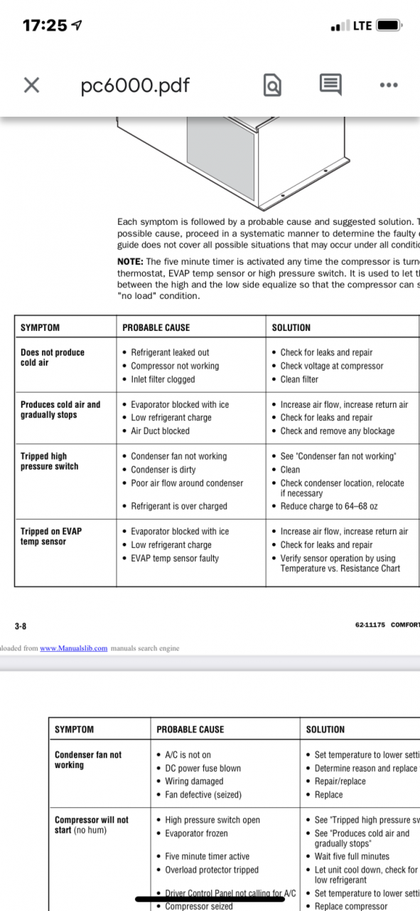

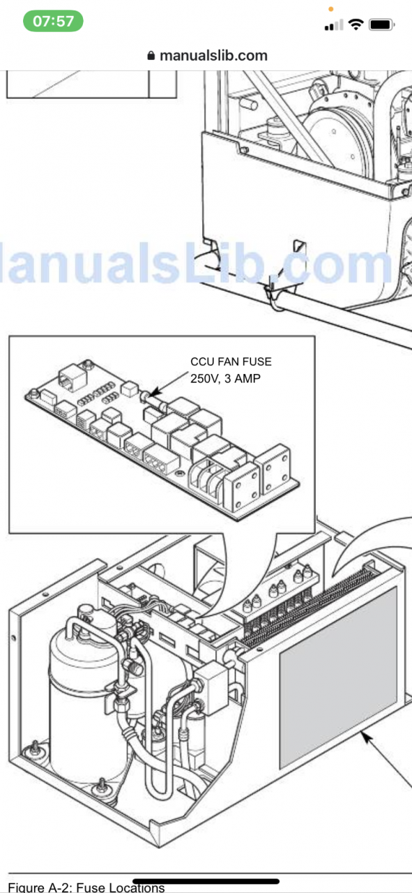

    1C80C96C-DF54-4464-B134-7E8832344FFB.png D915EF5A-8B07-46F6-ACDF-069FA3269A72.png AC7DEDC4-822A-4029-B5FF-1CCF827337FF.png A6DB289D-A03D-4B70-ADD6-724E2FF662D5.png 3B076E99-A804-4A00-9BD4-7D77AE9ED300.png AC7DEDC4-822A-4029-B5FF-1CCF827337FF.png D915EF5A-8B07-46F6-ACDF-069FA3269A72.png 1C80C96C-DF54-4464-B134-7E8832344FFB.png

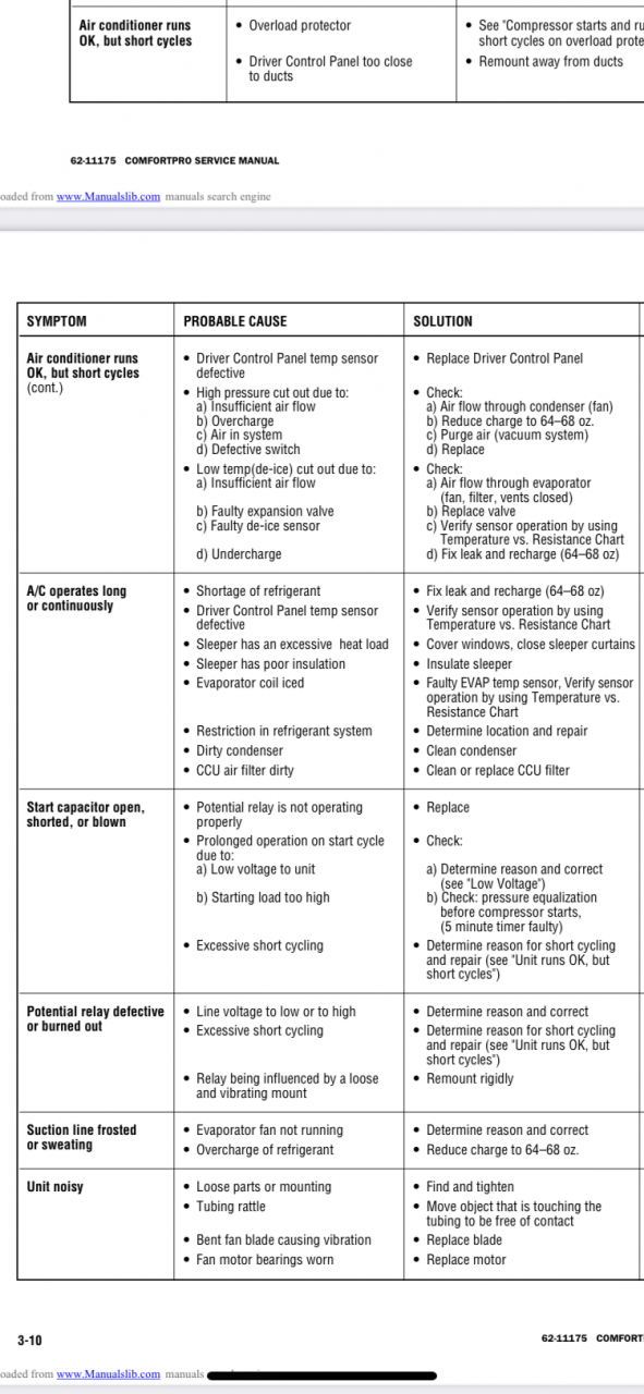

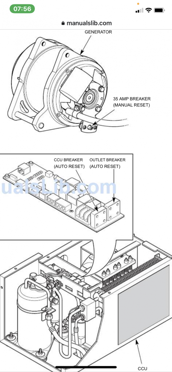

    Attached some troubleshooting steps from manual and maybe give ya an idea
