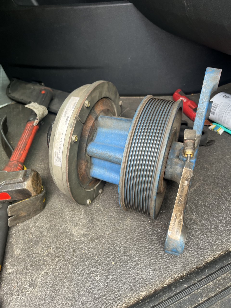

    got the hub and clutch out and somewhat inspected it. One of my concerns is the brass air fitting. It looks like it can stand replacement. Also I just heard that the hub bearing should be replaced as well. Anybody heard that before? I call kit masters and got a part number for it. I’m editing on the new clutch. I’ll upload photos of the hub once I get the clutch off.
  11. AModelCat
    29,694
    164,728
    Never had to rebuild one but I would make the assumption there is a spring in there to either release or engage the clutch.
    Use caution, nobody likes to get smacked in the face with parts.
