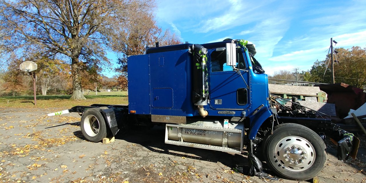

    And also what is the length from the center of the tandems on the truck to the center of the tandems on the trailer when they are pulled all the way forward on a 53' dryvan?
    The truck itself is an FLD 120 with a setback front axle. I would have to call Freightliner to get the exact wheelbase. Here's a photo before I put the engine in and the back rear in.
