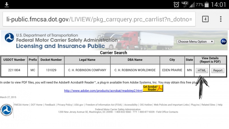

    If their phones have been disconnected, I'm filing at day 31. If they answer the phones, acknowledge the debt, but don't have payment yet -- I'm filing at day 60. If they've been in business forever and have a history of slow pay, maybe I give them a little more time.
    As for how to file, go to: http://safer.fmcsa.dot.gov/CompanySnapshot.aspx
    Enter their MC# then click on licensing & insurance:
    Then click on HTML:
    On the next page click on "active/pending insurance:"
    Then click on the surety agent:
    Then call the phone number and ask how to file on the bond & what documentation they require.

    Thank you so much for the help. It has been filed. Hopefully it will get taken care of.
