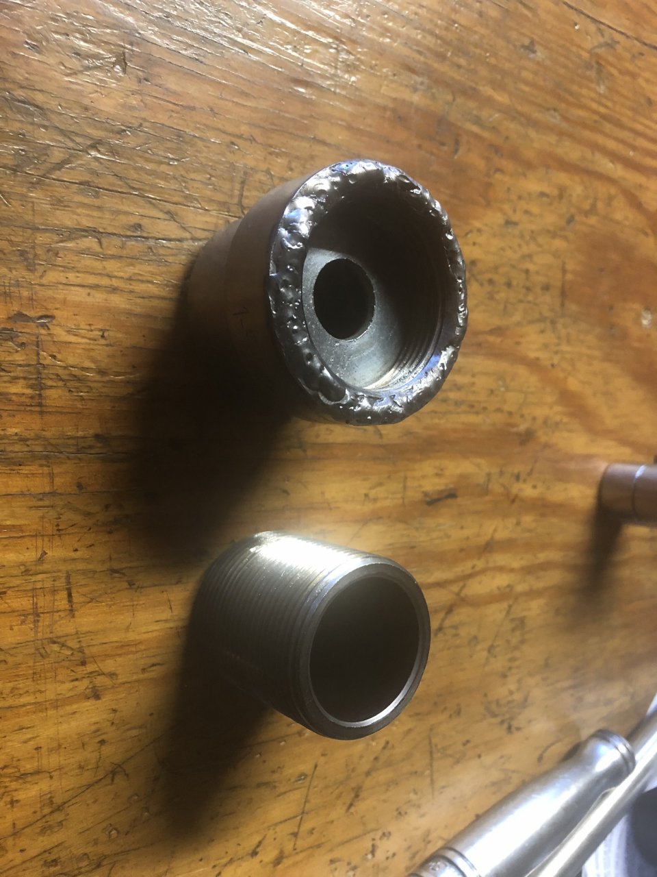

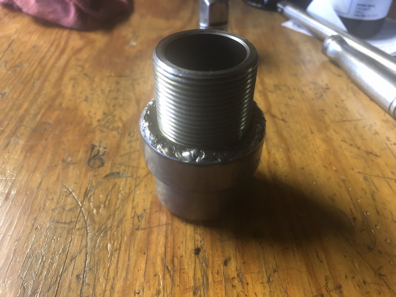

    E90F3234-9797-4668-9106-53A521B0B1CA.jpeg A73AC197-BC5E-40FA-91E9-57651C440E1D.jpeg I did an oil change on my 14 liter today and when I pulled the filters I decided to check the inserts.
    To my surprise I was able to back them out by hand and they were only holding by about two threads.
    I went to my tool box and grabbed the insert installation tool I made this past February and I’m happy to say it worked perfectly sinking those inserts deep in to the housing and nice and tight.
    I’m thankful I looked at them and believe I was headed for certain disaster shortly if I hadn’t taken the time to check them out.
    I will now put the tool on them at every oil change as part of my service program and recommend that others do the same when servicing these Detroits to avoid a disaster of an oil filter falling off.
