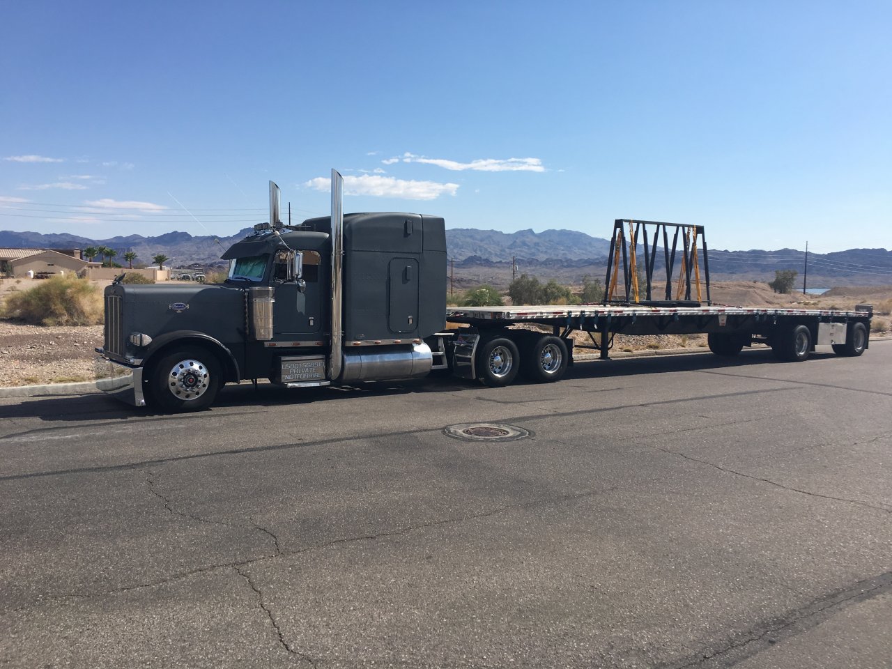

    I believe they have some other frames that are specifically for granite. They include them briefly during the securement training in Little Rock.

    lake havasu city az
    Yes this a frame on my trailer is made just for hauling granite slabs.

    lake havasu city az
    Absolutely not laying flat. They must be upright at all times u till they go to get fabricated. They would crack when you went to strap them down if they laid flat.

    It's a pretty sturdy material if you know how to properly handle it. Most slabs these days have fiberglass mesh epoxied on the back. It's just becoming common practice. I'm actually headed to the great state of California today to pick up a bunch of slabs. I'll post some pictures of how there loaded ect to show you guys who are unfamiliar with the process on how it's done.
