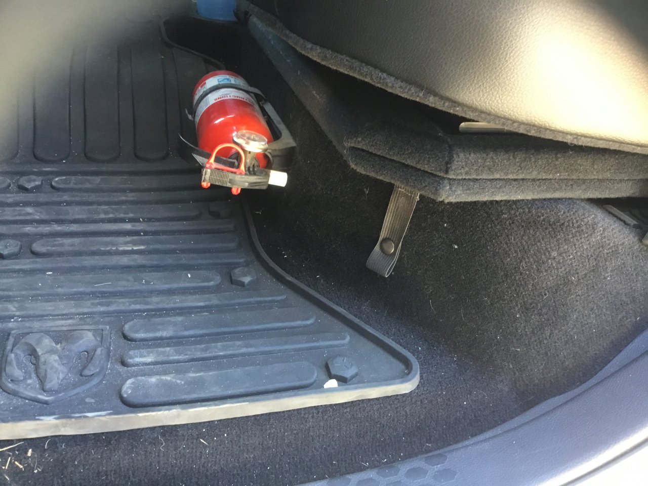

    3B0332D4-896C-4A00-AB32-F34F34EEBEC1.jpeg I mounted mine inside. The drivers side rear door below my rear seat.

    Mount inside so it won't be stolen, I use the smallest one available 3 lbs unit look just like the one in the pic.
