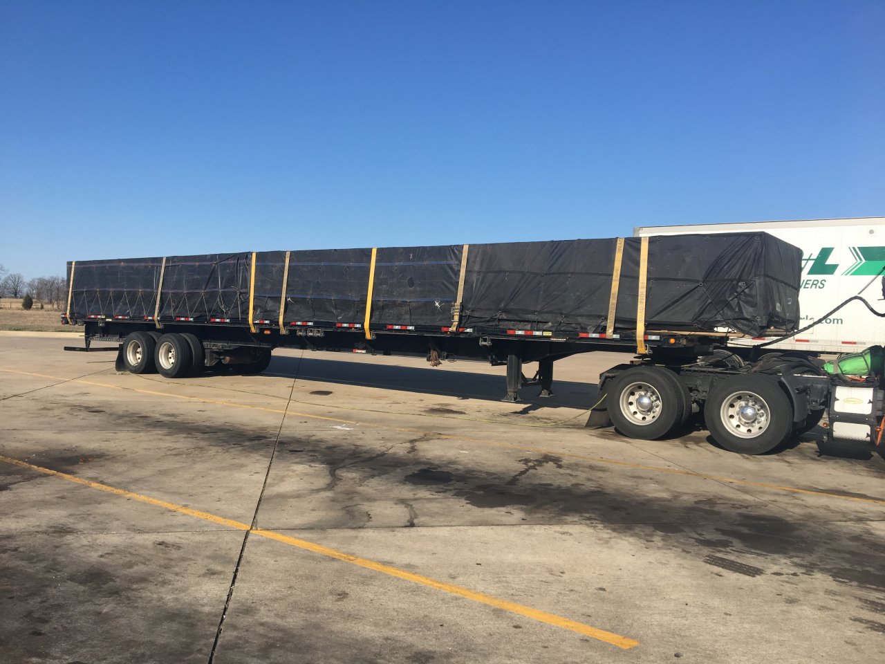

    We don’t run bulkheads on any of our trailers. They get in the way and are not required. Unless the load is touching a solid bulkhead, in an accident they aren’t going to do anything anyway. Once that load starts coming forward it’s not going to stop at the bulkhead. 5BE9E02E-52E8-4731-9F02-F7A760F0A7CB.jpeg A7AF06F2-BB89-4E71-A32A-3DA4F1E77CEC.jpeg

    Use enough securement that you could hang the trailer upside down and nothing would fall off. Some cops will write a ticket for improper securement if anything falls off in a roll over incident.
