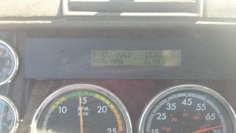

    I have one with 100,000 miles on it, no problems except AC compressor and it was I repaired under warranty at Freightliner. I purchased it in March of 15 and have had a driver in it. Not one repairs other than that. When I bought one in March you could not get it with a CAT even if you supplied it. At least that is what I was told. You had the choice of the Clarke or the Fitzgerald motor and same warre try on both. With a driver in it my truck is getting 7 mpg and uses no oil between oil changes at 15000 miles. Used about a gallon per oil change for the first 50000 miles.

    This is an old thread and I did buy another Glider from Fitzgerald in June. This time I got the 389 with their in house Detroit, 13 speed and 3.55 rears. Truck now has 55,000 miles with no issues.
    The first truck (Columbia)I bought from them in March of 2015 just turned 215,000 miles. It has had the AC compressor replaced under warranty and 1 broken manifold bolt replaced under warranty. And only missed 1 day on the road for those repaires.
    Looking at getting another truck from them at the first first of the year. Fitzgerald has been awesome to work with and I will continue to buy from them until they treat me otherwise.
