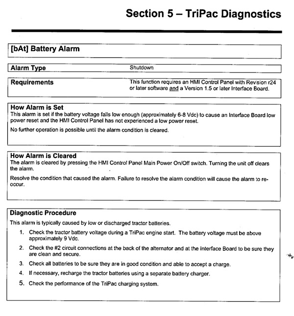

    09A4746A-D4A6-47AA-8032-46BB4DB0BB8E.jpeg You've probably got a flakey connection at the 50 amp Maxi-fuse which is located by the starter. Bat code sets when the control unit sees low voltage. I recommend chopping that fuse out of the harness—cut the wire off at the fuse and pull it back through the harness (slit the fabric covering in a few spots so you can access the wire to pull it) until you have enough to reach directly to the batteries. Go to NAPA and get a 50 amp fuse and fuse holder and attach that wire directly to the batteries.

    And your blower fan may not be bad, it just isn't getting enough voltage to run. Are you having any trouble starting the truck?

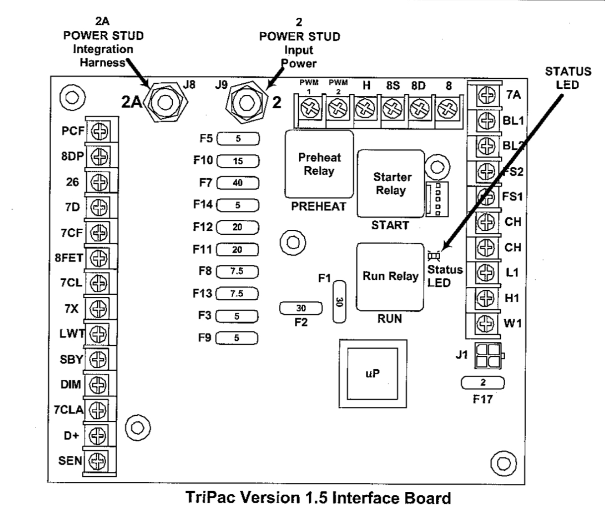

    ECF2EDC9-E638-40A9-BB52-A6C6F77FB9B5.jpeg If you're just using it as living quarters, take the battery cables from your APU and hook them to one battery—the best one in the set—disconnect all the rest. Then run a piece of 10 gauge wire from terminal 2 in the control unit to the positive post of that battery. Make sure you put a 50 amp fuse inline.
    This is assuming the APU alternator is still good, which I suspect it is.
    What are you using for 110v? Is it parked somewhere you can plug it in?
