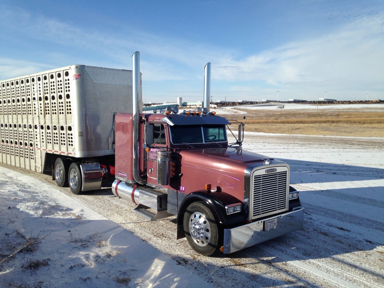

    My brother bought this truck in CA at the first of the year. It's a 2001 with a 525 Cummins in it. 80k on an overhaul and he gave $30 for it.

    I totally agree they are a good truck I just didn't like it. Whoever bought ours is getting a mechanically and cosmetically excellent truck. 600k original miles.

    Good looking truck and a very clean look.
    How many miles on the truck?

    850k when he got it. Overhauled and new transmission 80k before he got it. The only unknown are the rear ends. It was a single axle and he had it built to a tandem using a cutoff.
