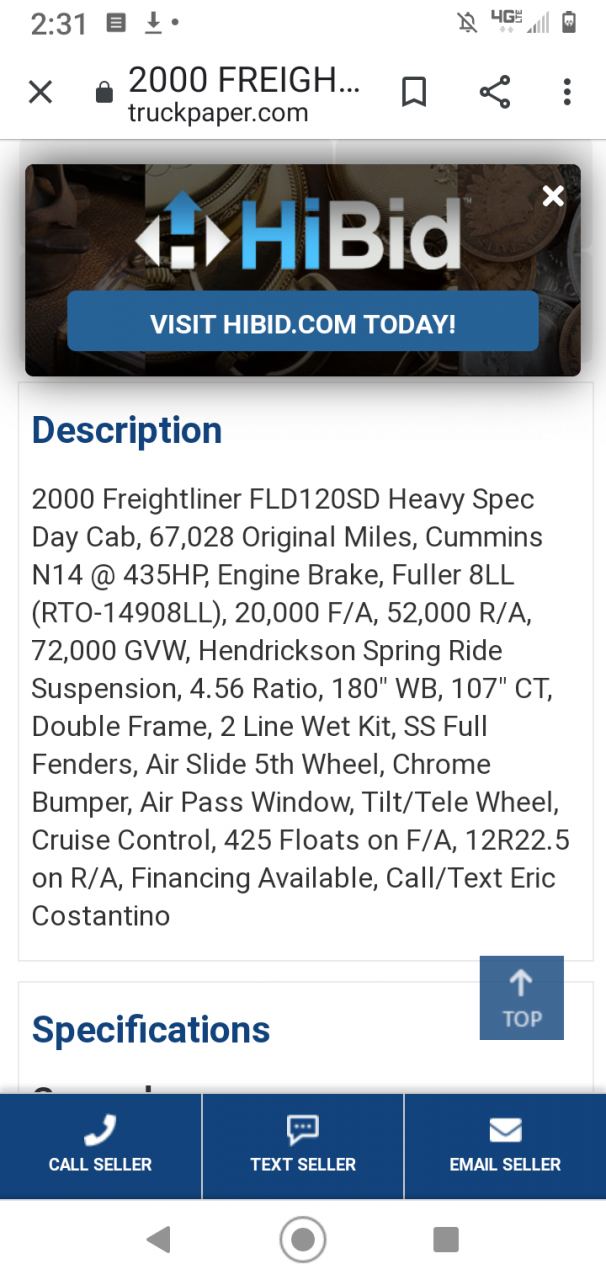

    Here is the actual listing btw

    It's an n14 celect plus
  9. daf105paccar
    6,564
    7,293
    Apr 15, 2012
    Springride...........better you then me.
    NYCgorilla Thanks this.
  10. NYCgorilla
    NYCgorilla Light Load Member
    66
    43
    Sep 29, 2020
    Ah...
    So not only will I get a rough ride from the 180 wb, but the spring ride will be rough as well.
    Good to know...
    Tug Toy and Dino soar Thank this.
  11. Diesel Dave
    8,673
    24,619
    Jan 20, 2010
    Hesperia, Ca.
    That’s a heavy haul spec out truck, unless your gonna do all heavy haul, I would walk away.
