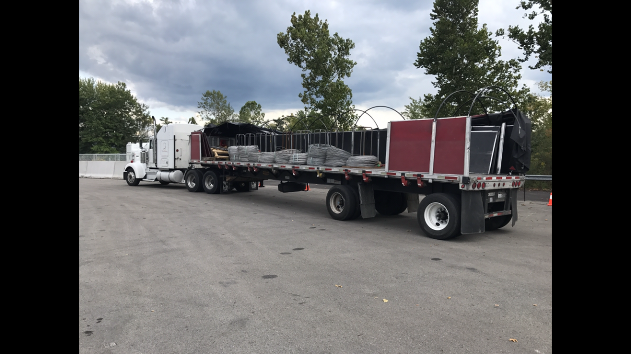

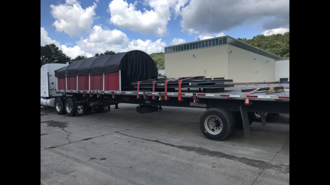

    5A5ABEBB-5673-4E22-9962-EFC11E3DB52A.jpeg 5E98953D-7D67-40BC-9472-734F59B50EA3.png 861918C8-5520-4F0A-A20A-691F61009A47.png 9032E938-D7D4-4602-81F0-1D310709FBA2.png They both have pro’s & con’s.
    For speed you can’t beat a conestoga, as long as you’re not doing 40’+ stuff all the time, or wider plates......

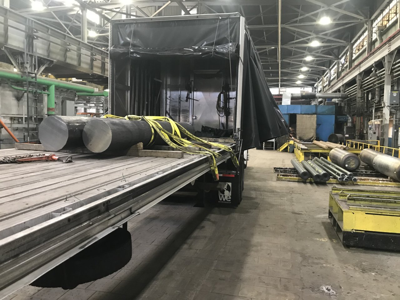

    If it’s a load that needs to be fully tarped, I should have been more clear on that.
    I’ve hauled 39’ material that had to be worked up inside the conestoga with a forklift. Loading with a crane is better in that situation. With the conestoga all the way to the front on mine, 39’ material would overhang if not worked up inside the conestoga a little....

    1st truck / trailer I ever bought in 1987 had a sidekit. At times it’s more forgiving than a conestoga, but you’re limited on height. These plates were wider than my sidekit stakes, if I had been using a conestoga I may have had to cancel this load. The conestoga I own is good for about 99-100” wide.
