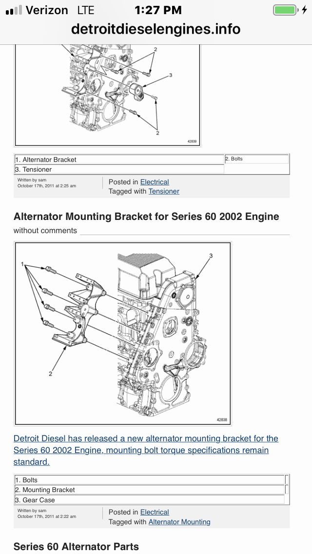

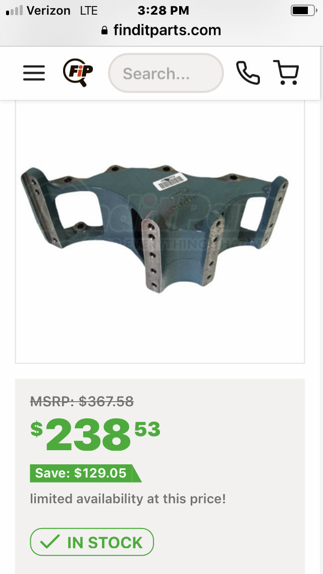

    567B02E3-704D-4E44-8170-6FC49D7DF899.png C8398C8D-1AC3-41B8-8341-82866B59D75B.png 322233E6-CA37-41F9-BEDD-453AAD35023B.png Nows the time to get rid of the old York a/c compressor if you have that kind. This pad mount bracket with Sanden compressor fairs better. Still breaks bolts though, if it ever gets loose, and wallows out the holes. The 2002 upgrade is best. I’ve never seen one. Would also need the proper front? or rear? cover. Note the 4 extra bolts. These were on eBay. I had to get the $238 one.
