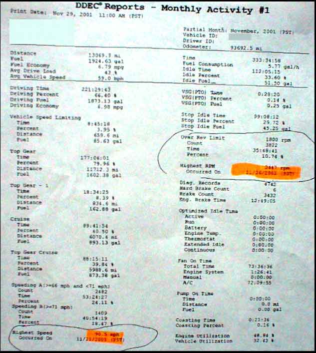

    Are you aware that the truck / engine keeps a lot of information on the ecm? These units have performance monitors connected to the transmission. The ECM can retain mileage from date of install. Here is a printout of what data is collected, including top speed. Notice the odometer reading in the top right heading...93692.5 mi. You can have a shop poll your data and get the mileage too.
    smctransferllc Thanks this.
  9. xsetra
    xsetra Road Train Member
    5,109
    6,972
    Aug 21, 2011
    What if the ecm was replaced.
  10. DustyRoad
    DustyRoad Road Train Member
    1,540
    17,104
    Feb 23, 2011
    Gulf of Mexico
    The Certified Detroit Diesel Tech has reprogramming software designed to update the new ECM with Vehicle Id, engine ID, ..... odometer reading when replacing a faulty DDEC.
    smctransferllc and xsetra Thank this.
