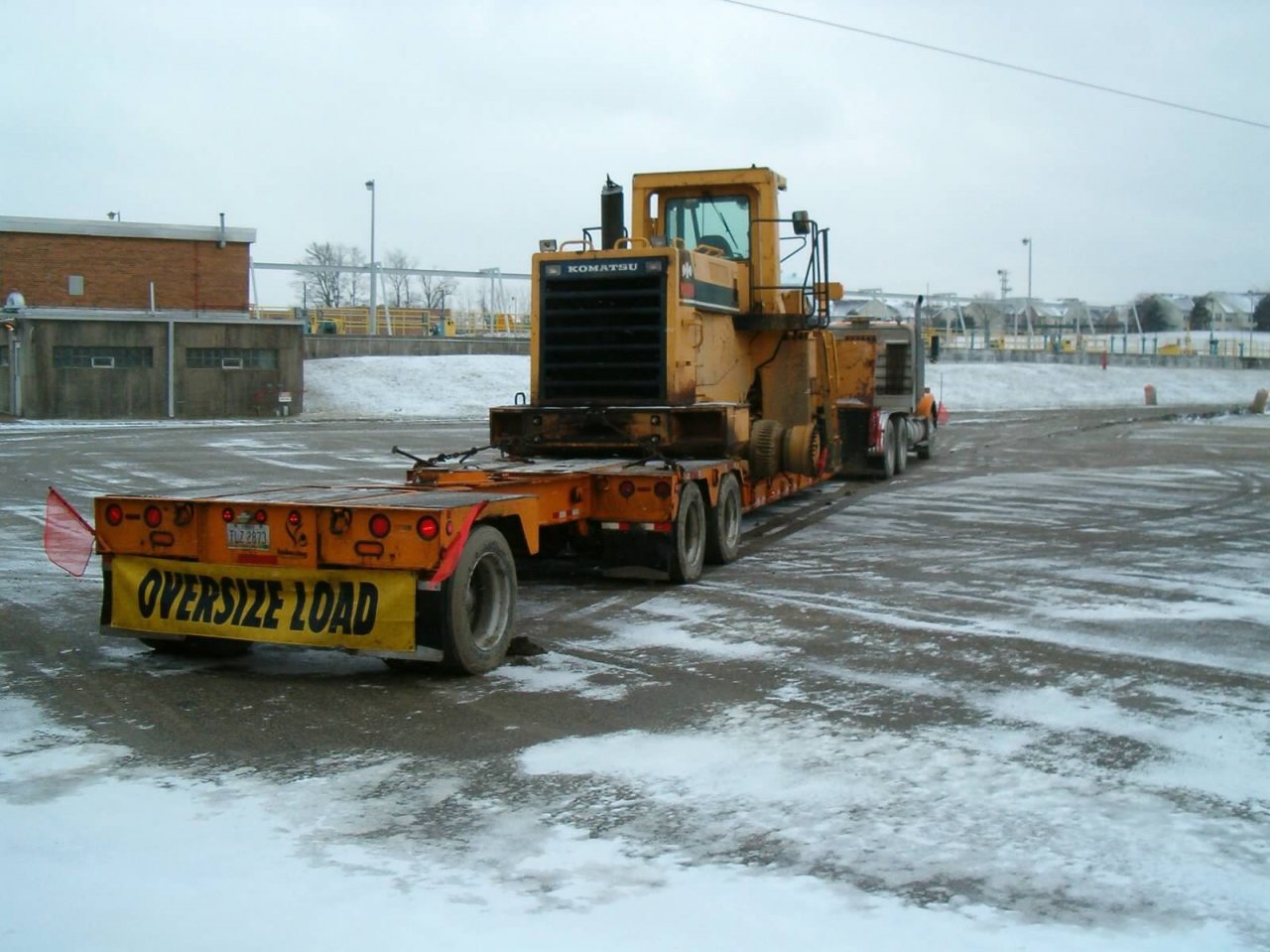

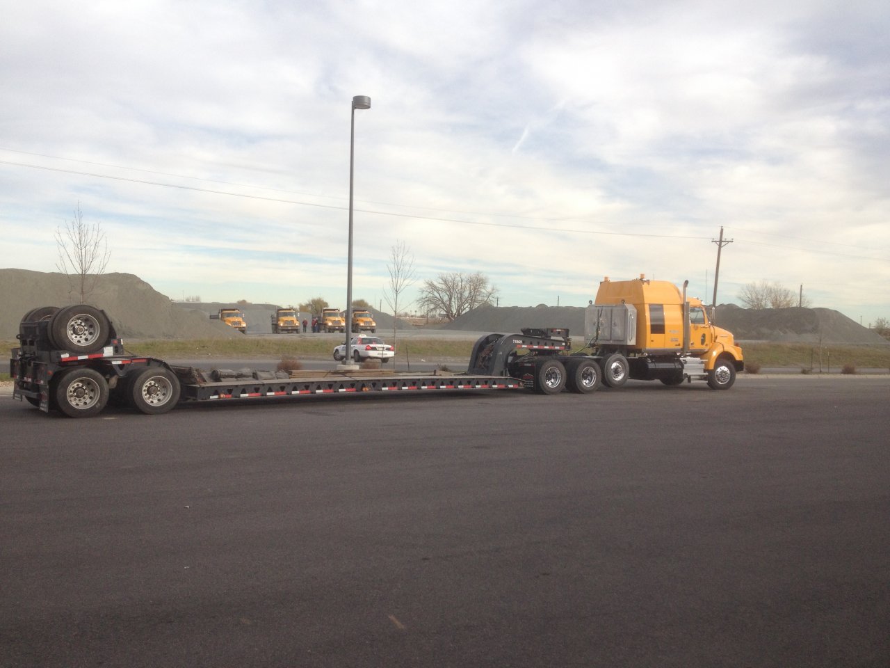

    They sure do, I pulled one for several years. In Ohio before the axle laws changed that's how we got to 120,000 on 6 axles before we went through longer necks, more 5th wheel slide, and bigger front ends then we could get 120,000 without the stinger. Here is the trailer in tri axle configuration;

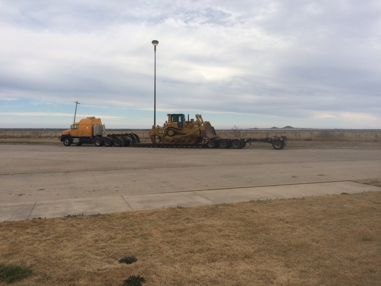

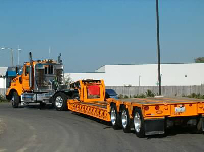

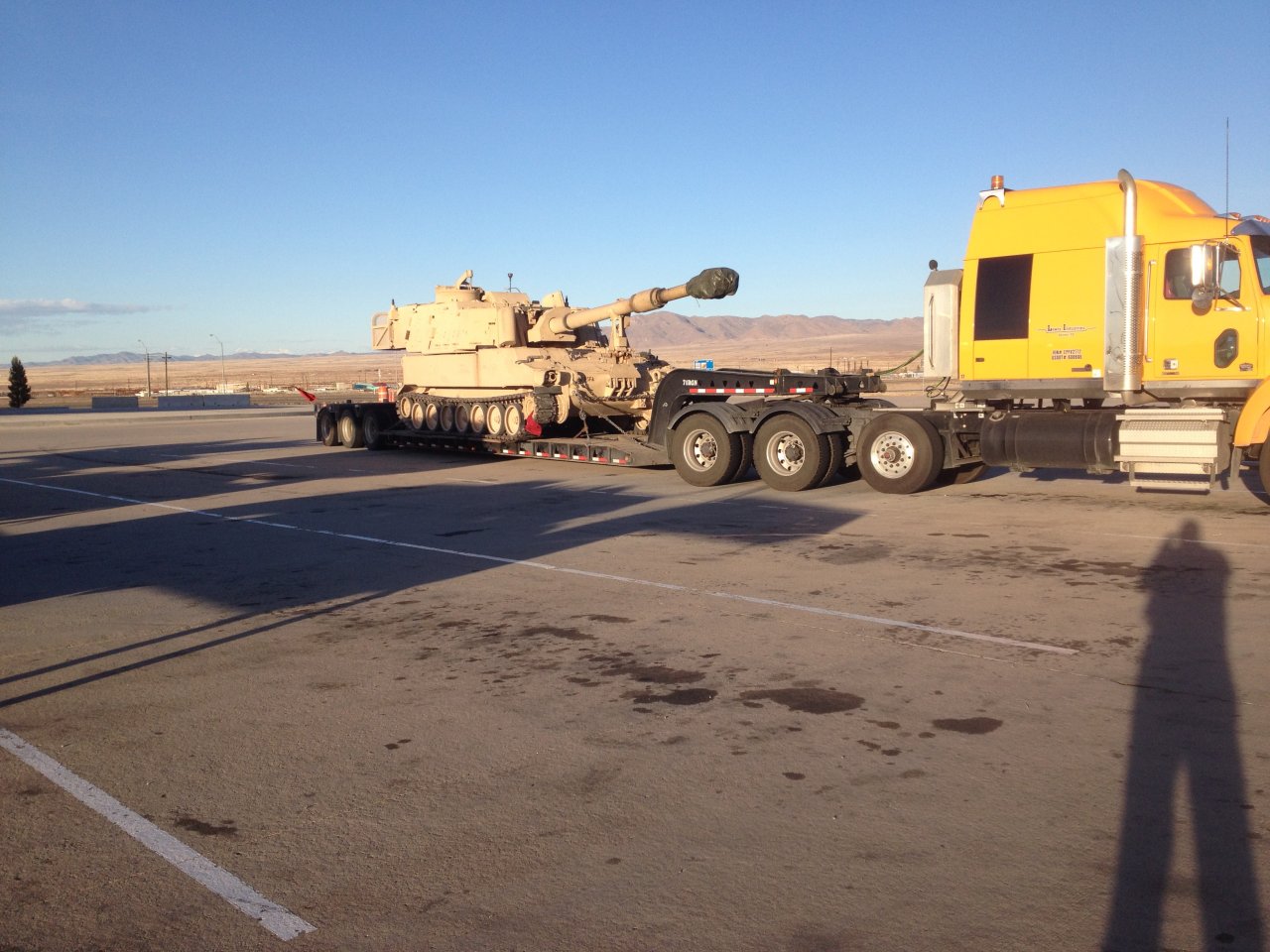

    I owned a 55 ton mechanical neck trail king with 29' well detachable wheel area with a 10' deck insert, flip neck, intermediate 3rd flip axle, air spreader bar and 4th flip axle. I could run as 2 axle, closed 3 axle, 2 plus 1 axle, 3 plus 1 axle and 4 axle closed.
    the trailer may still be for sale at transwest in denver.
    There are trailers out there like this... they may be hard to find and are heavier than traditional 3 axle trailers.

    johndeere4020: Correct me if I'm wrong, but you cannot hook the stinger up behind that tri, right? I'm not seeing anything to mount it? Has to be as a tandem to use it?
    Rontonio: are all three of those pictures the same trailer? (the first pic and third pic in particular)

    Yes they are.
    The important part is you must have a flip axle built as "intermediate" flip axle for the 3rd axle. This will have the exact same attachment points as the back of the trailer so you can mount either the 4th axle or spreader bar to it.
